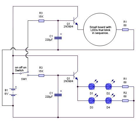

    As a side question if I wanted to install a 2 way switch and I have a small board that randomly makes a set of 4 leds fade on and off would this layout work? The first circuit is what I wanted (I think) but I thought maybe an add on would look nice where the multicolored ledboard added to it would look good when I flipped the switch one would fade out as the other single colored LEDs fade on so I can go from multi blinking colors to a single color with the flip of a switch and have a awesome transition between the 2. I'm probibly making this too complicated but it seems cool in my minds eye.

    the 15k resistor and the 220uF capacitor create a RC time constant. google "RC time constant" to find the equation and how it relates to the amount of time fading that you want.
    note that the 68 ohm resistor limits the current sent to the LED's. therefore, for your additional circuit that you added, a 68 ohm resistor may not do the job, you may have to go up or down. we would need more information on the "small board with leds that blink in sequence" board (like a schematic) if you want us to provide exact values. there are stickys that explain the whole LED and current limiting resistor if you wish to do it yourself.

    The circuit you posted has a symbol marked with a SW1 which implies and on off switch is present I just want to swap that out with an on off on switch so that when the switch is in the 2nd on position the 2nd circuit comes on and the 1st circuit goes off.
  17. cpemma
    cpemma Ecky thump
    27 Nov 2001
    12,328
    55
    You don't need the resistor, capacitor and transistor in the second circuit, just a SPDT switch instead of my SPST, to switch 9V to the second circuit.

    but he still wants the second circuit to fade...
    i'm confused if you already have the circtuit Satyric_saint or if your designing it...
    anyway, post the board and i guess we'll see.

    You'll have to find out what happens with the flashing module when you steadily reduce the supply voltage. It may just go off rather than fade.
