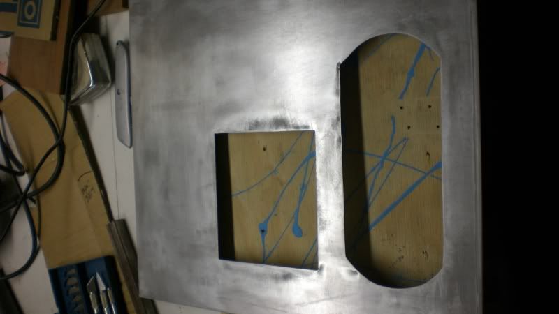

    I'm practicing on an old case, cutting a window and I decided to experiment with paint as well. I started off with sanding, but it takes forever, and uses a ton of paper. I got down to bare metal and I like the look. how can I best do this with the remaining pieces? i've read that chemicals are the best, but I also have access to heatgun. sandblasting is out of my budget.
    I've read that oven cleaner or pinesol, or hot vinegar work well for this, as well as commercial stripper.
    what do u use/recommend?

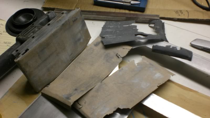

    Seems like paint stripper is the preferred method! Any particular kind I should look for? I'm not certain what type of paint is on this case (or even the material of the case), I'm suspecting its acrylic. I've got some ancient oven cleaner which I can try out, the warning labels said not to use it on something (i forget what, but at the time, it seems that that something (paint) was what I was trying to strip!)
    I've got a beatup old black and decker finishing sander (orbital) which works ok (way better than my hand or sanding block.)
    Here's some pics of the progress and the tool. Notice how I've torn through 4 sanding surfaces (first one was Wet/dry 320, then I bought a sheet of 180 and sliced that up to fit the sander.)
    Edit- I just learned a sanding tip I want to try out. Attaching ducttape to the back of the sandpaper helps prevent it from wearing out like seen in the last pic. (Course, I want to strip it first with something chemical easily.)
    Initially:
    several hours later:
    even later (i'm liking the look):
    Sander and paper:
