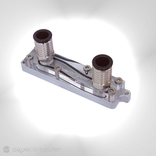

    I got some new toys coming from Austria this week. The fun one is this little cutie:
    AFAIK, Sharka wasn't able to get any of these or the AquagraFX 7800 coolers as they screwed around to long with their ordering. :lol: I ordered mine the first day they came out, but I didn't want to hold up my last shipment so it should be here in a week or so. :hip: One bright spot is that Sharka dropped the price on the Aquaero VFD's from $280 down to $170 USD. :thumb:
    Now I got to drill more holes in my case. :waah:
