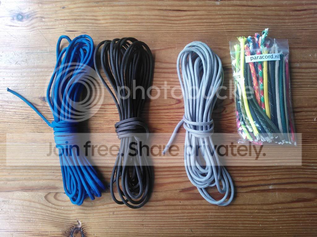

    Paracord To sleeve all the cables.

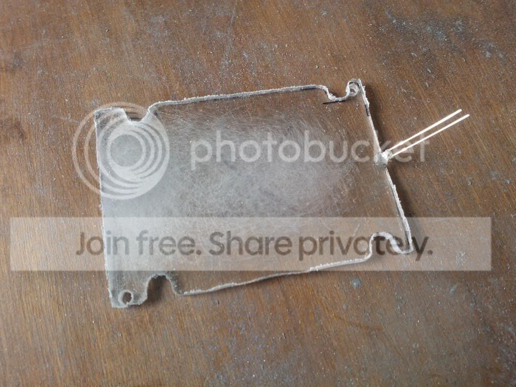

    The plates which will cover up the motherboard are made out of poly carbonate. This material is also used in bulletproof glass. It will bend but not break when you cut it.
    First drilling the holes and after that cutting away the parts.
    Here you can see that the poly carbonate plate almost fits on the motherboard.

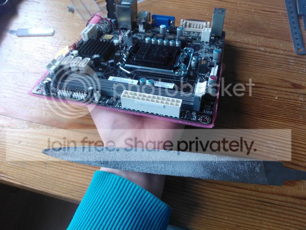

    I had to modify the motherboard a bit to make the front poly carbonate plate fit. I used a file to cut away a few edges.

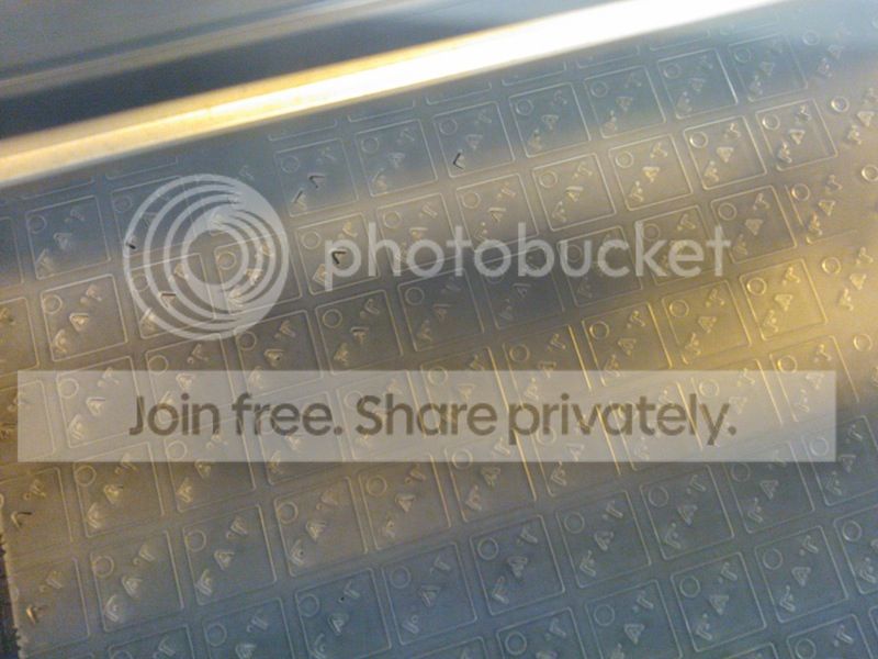

    I gave both of the plates the same frosted texture. The light of the LED’s will spread nice and evenly because of this surface texture. It wil diffuse the light.
    I used my diamantpowder tool to scratch the surface. It takes quite some time but I was really pleased with the results.
    Difference in surface textures.

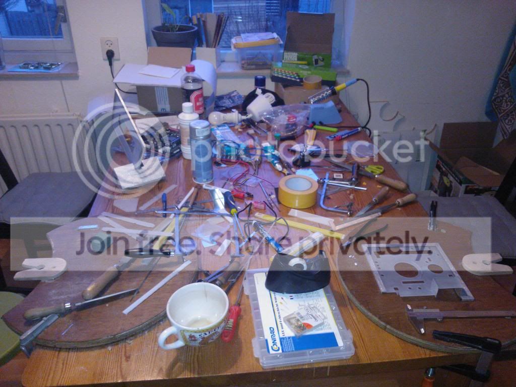

    Meanwhile my kitchen table looked like this...

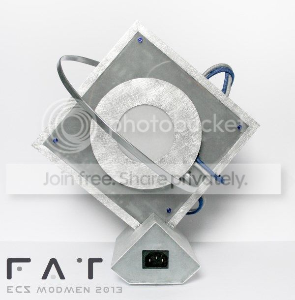

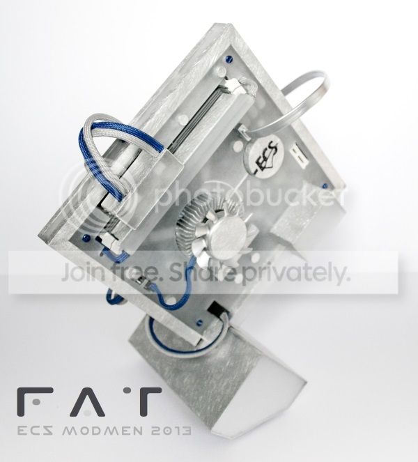

    This build is especially very compact. It is 22cm high, and the case surrounding the motherboard is 19,5 x 19,5 cm and 2cm thick.

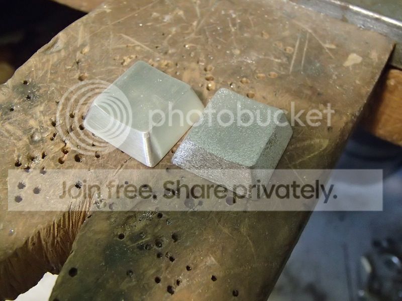

    I made a wax ‘Ideal’ keyboard key and casted in brass. Then I made a rubber mould and made more wax keys.
    These keys were casted in silver, so you can mass produce silver keys ;) !
    Here you can see the casts.
    This is what I want to engrave.
    First finish the keys.

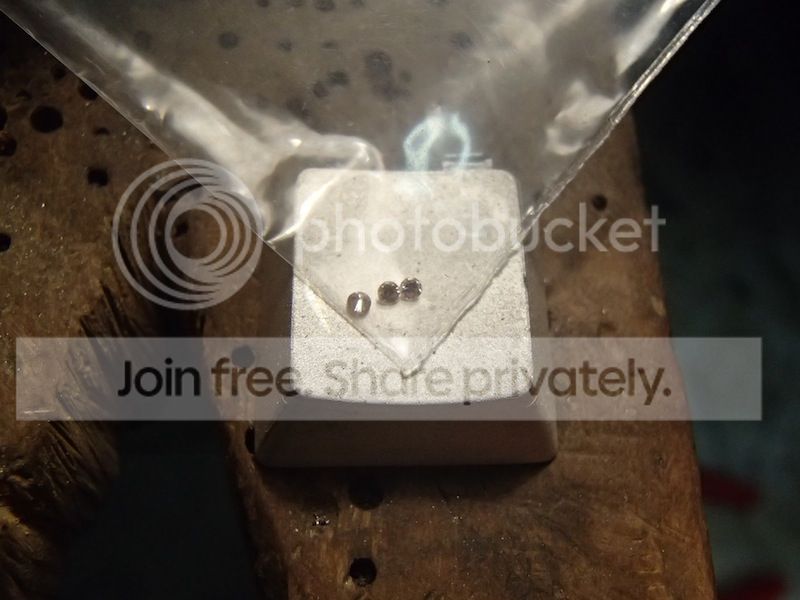

    I still had 3 tiny diamonds which I will set in the ring.

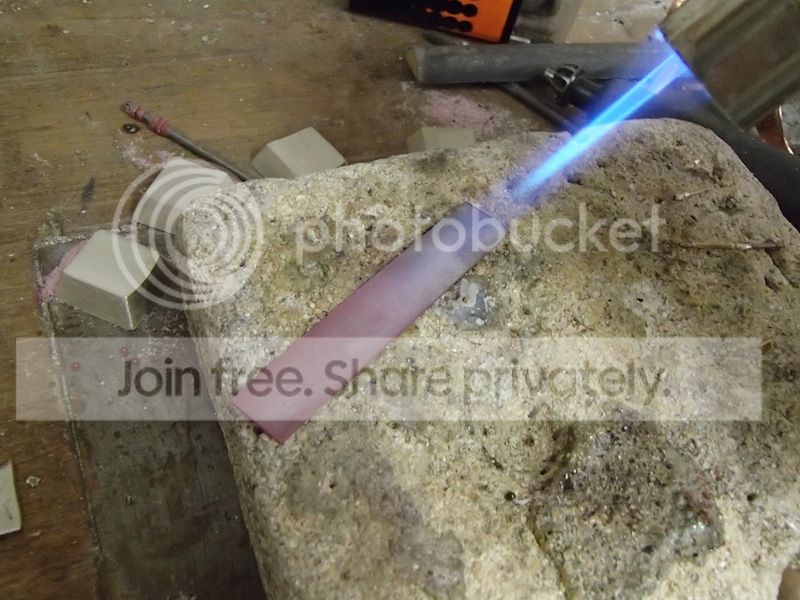

    I have enneald the silver so I can bend the material easily

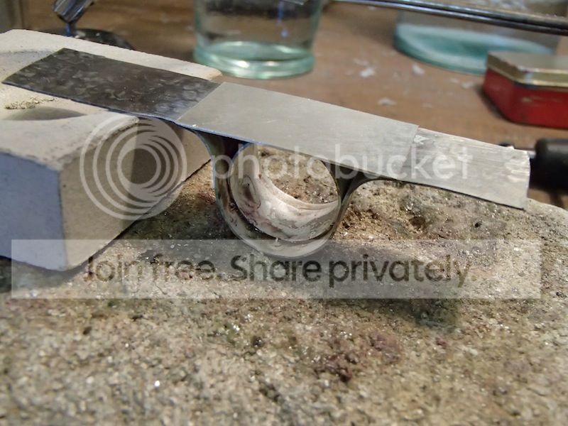

    Then bend the silver and solder it together.
    To make the ring round you have to hammer it.

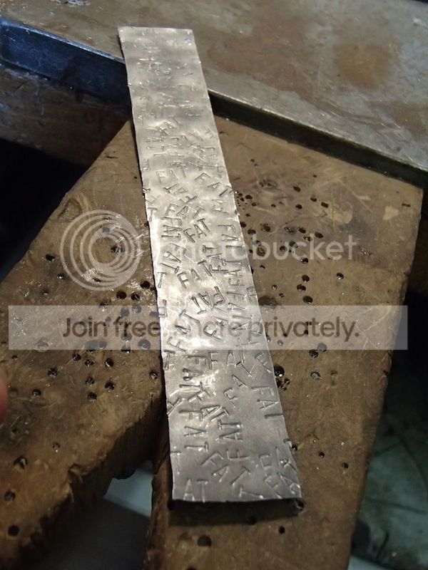

    To make the backside of the ring more interesting I have stamped my initials in the silver plate.

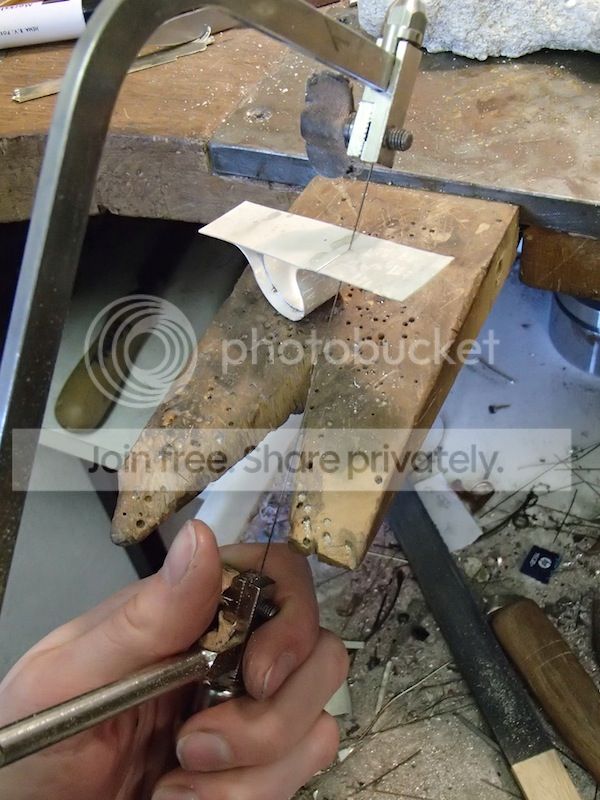

    To cut away the logo I used a engraving tool.
    These 2 elements will be the frame of the ring, I will have to solder them together.

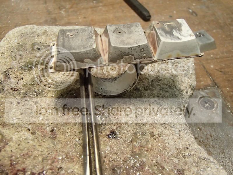

    A silver plate that goes across the gap so the keys will stay in place when I lay them on, and solder them.
    After you solder the silver there are a lot of oxides, so I always use a chemical to clean the material. It makes the silver look snow white.
    Cut away the extra material.
    One of the diamonds, they are so tiny!
    Soldering everything together.

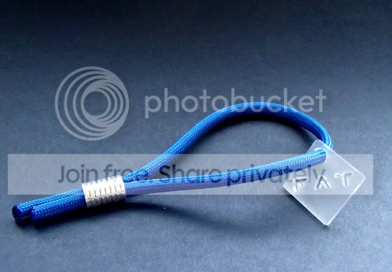

    I also made a few goodies with me to Taiwan to hand out to people there. It was a very interesting day ;) !
    The lasercutter.
    First a few testplates.
    The real stuff ;) !
    The lasercut goodies :)
    Interesting day :D !
