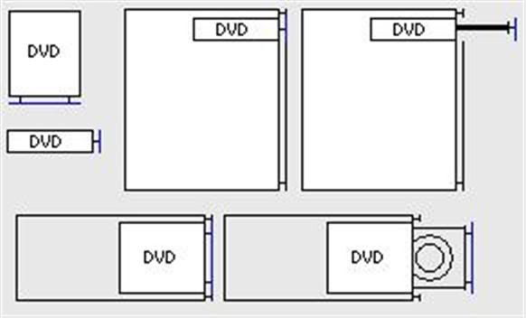

    Looks good to me, for the fan, try placing a sheet of plexi 1cm from the front and see how much air is drawn, if it seems to be enough, then that will be fine. I like the idea of the plexi front as well, but don't make the hole for the DVD drive that big, make it only as big as it needs to be, or better yet, stealth it with the drive.
    Like this maybe,

    Oh yeah i totally forgot that. Ive taken the dvd-drives front off and i plan to cut holes in both the alu and plexi for it to fit. The alu i cut away to make space for the drive to open, will be glued ONTO the drive instead of the boring plastic. This way, the front will contain it's style :)

    You need to remember to be able to open the drive by pressing the button, so beware of taht if you stealth the drives.

    I know. I thought about how i could make that work, and came up with something like this:
    On the backside of the aluminum attached to the front of the drive, i'll melt a little metal-cylinder just long enough to reach the open/close button. This way i hope the aluminum will allow me to simply press the the lower right corner of the plate in order to open my tray.
    I hope you understand what i meant ;D if not, i can sketch it for you :).
    I didn't really decide what thickness my aluminum should have yet, but im thinking something like 0,5-1mm?
    Honestly i haven't really been working with aluminum before so i dont know how thick it should be in order for me to work with it.

    Another thinkg you could do, is mount the DVD drive forward and maybe covered it in a mirror like finish or something, look different but I dont spose it would fit in aswell.
