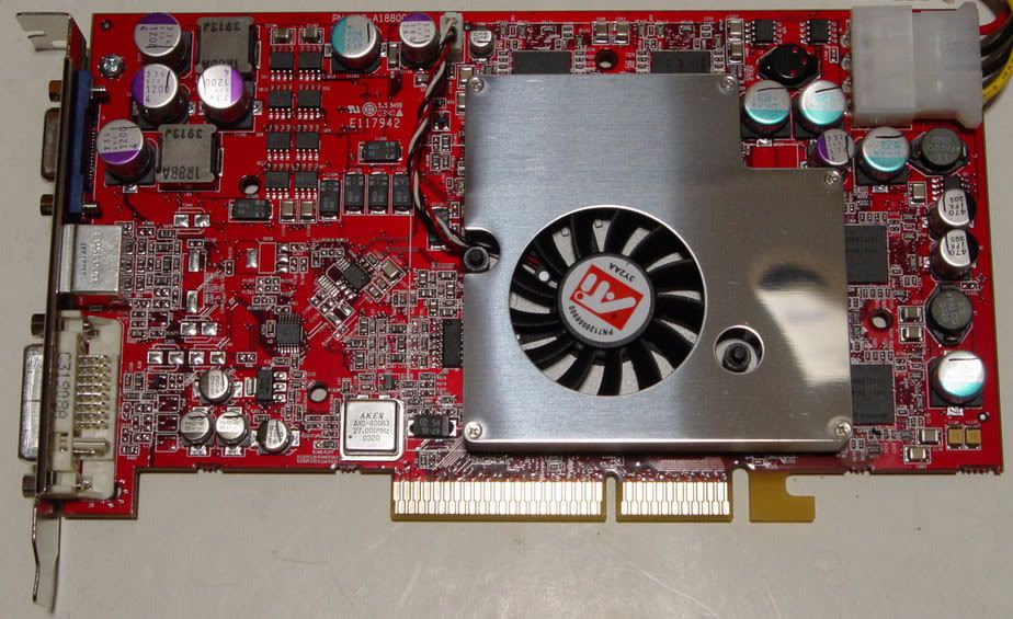

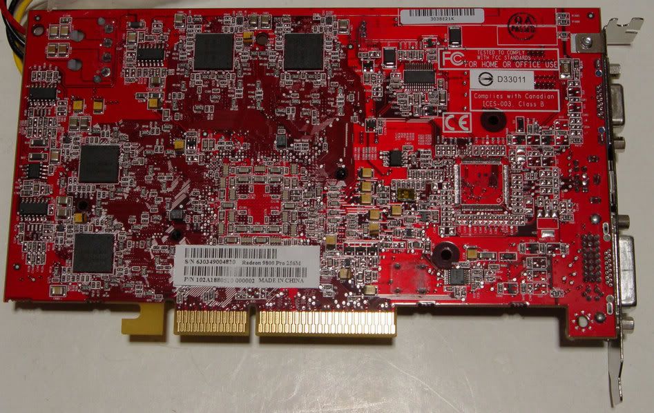

  14. DanMcr
    DanMcr What's a Dremel?
    27 Jul 2004
    366
    Once flashed, some cards let you monitor the temp in ATi tool. Doesnt work in ati panel though, and the overdrive feature also doesnt work.
    I had a picture somewhere of the little chip that needs to be present on the back of the board for it to work. If i find it, ill post it up.
  15. Piratetaco
    Piratetaco is always right
    15 Apr 2004
    2,746
    this
    and this might help.but i swear there are better pics out there that show you lm63 .

  17. DanMcr
    27 Jul 2004
    366
    Thats the very fella! You got the memory of an elephant.
    :D
    Hers the pic. Different to the one i had a while back. But nevermind.
  18. Tim S
    Tim S OG
    8 Nov 2001
    18,882
    89
    if that's the case, it is possible to mod the LM63 temperature monitor on to the board, providing you have the exact same PCB as one that DOES have the LM63 chip... there are a few other components required IIRC, but I do know of someone who did successfully mod their 9600 XT to have temperature monitoring.
