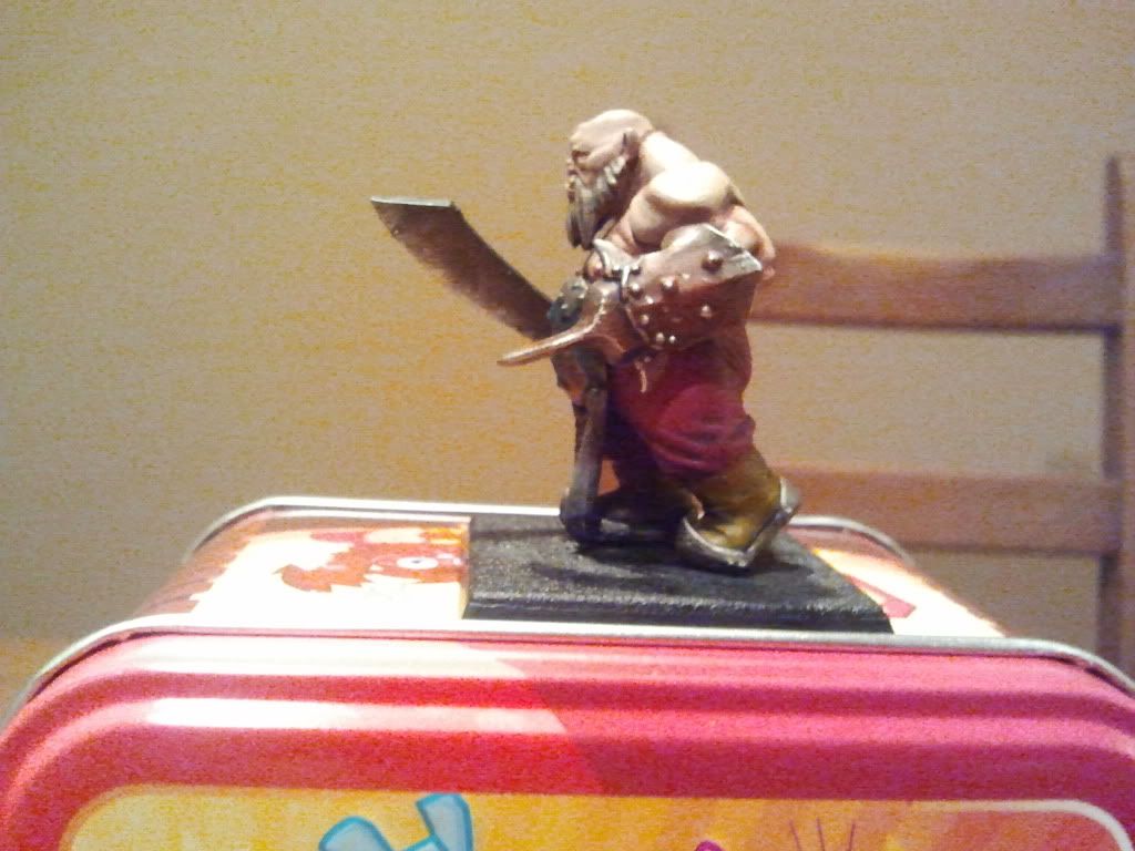

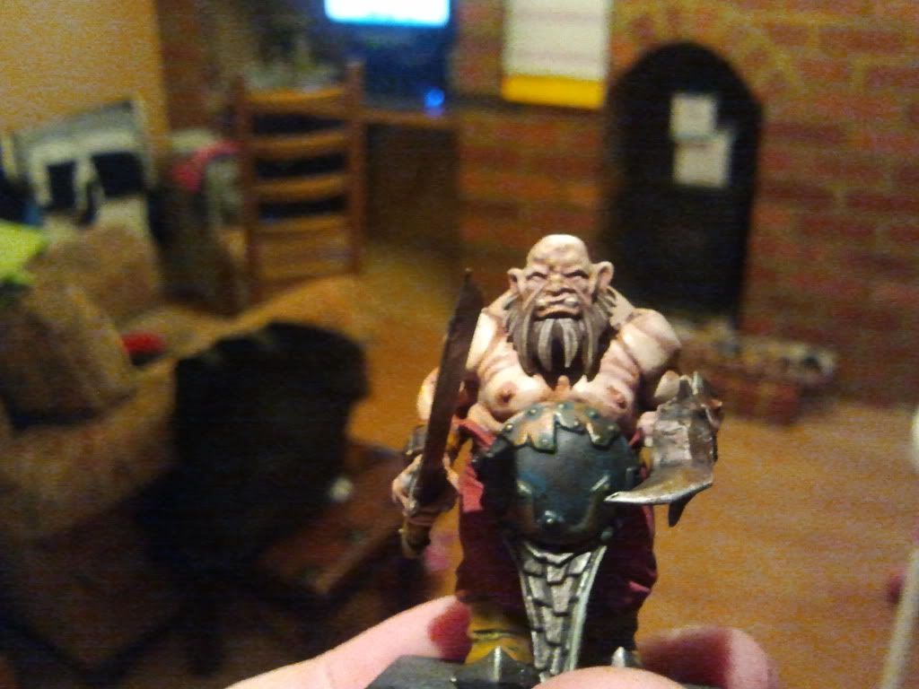

  17. [ZiiP] NaloaC
    [ZiiP] NaloaC Multimodder
    9 May 2008
    4,677
    306
    Very nice discolouration on the brass/copper on the stomach plate!
    The ogre lord should be fantastic when you're finished :D
  18. philheckler
    philheckler Used to be a pc enthusiast
    23 Apr 2009
    1,151
    9
    Thanks - Brass is a 1:1:1 mix of tinbitz / snakebite leather / mithril silver , centre of the gut plate is just tinbitz with a wash of good old devlan to dull it down... once dry the gutplate centre was washed again with very watered down hawk turquoise which was also applied individually to each rivet , once dry (with the help of the wife's hair dryer) i washed the whole gutplate again with devlan mud which calms down the turquoise and pulls the colours together...
    ps sorry to constantly inflict such crap photography on you guys , my galaxy s camera is really crap indoors but its the best i've got....
  19. [ZiiP] NaloaC
    9 May 2008
    4,677
    306
    Since the quality of the work you do is so damn high, I think we can forgive you for the fuzzy shots! :thumb:
