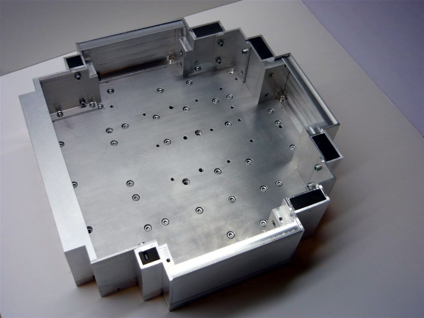

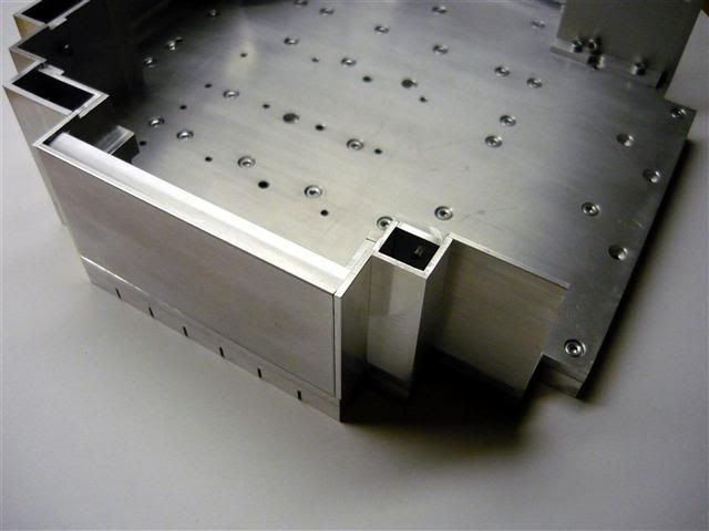

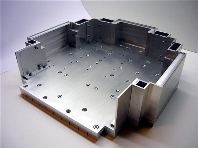

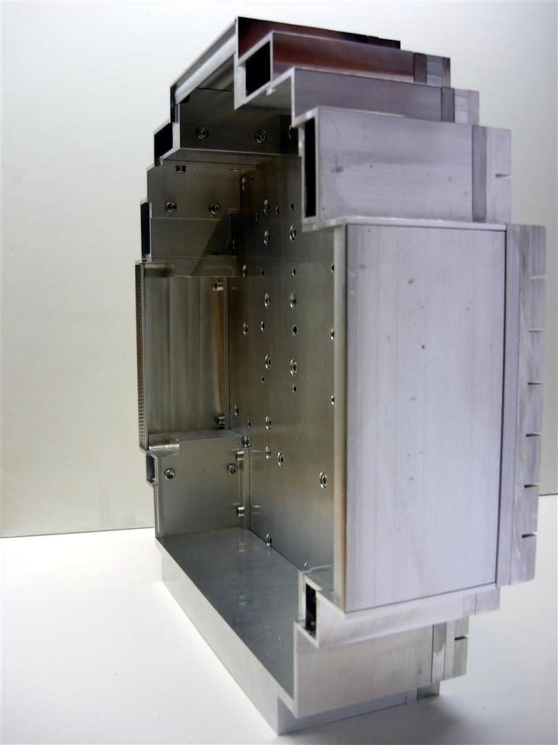

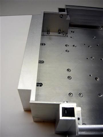

    Back again, with the final progress of the sidepieces. This time i've spent a lot of time finetuning all of the sidepieces and I've had my first real battle with tolerance chains. For those not familiar with that: it's basically, if you make several pieces that is supposed to stack together. Each piece will have it's tiny variations in the dimension and these will add to the next ones when you stack them. And In the end you might end up with a pretty big missalignment.
    So I've been assembling and dissassembling over and over again, while finetuning each piece until it all fits. Doing this when you don't have any parallel work holders is not fun.
    Anyway, the finetuning that is left is handed over to the final clean up prosess. So here it is, the last pieces of the side frame.
    I had to test the foot to see if it fits, and it snapped right into place. Turns out the fit was so tight in each corner, I could lift the whole thing and the foot wouldn't move even though there were no screws. On these rare ocations when you achieve results like that, you just smiiiile :)
    You might have noticed that there is a lot of dirt and scratches on the whole thing, I won't bother cleaning it up until it's ready for anodizing.

    :jawdrop:WOW to get that kind of a fit with the foot after so many seperate pieces is absolutely amazing :thumb:
    Your work on this case is inspiring :D cant wait to see more updates and the final finsihed case :clap:
