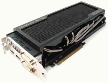

    Tundra was talking about to different GTX 570s. The Twin Frozr III and the Phantom. The Twin Frozr 3 is one of MSIs custom coolers and the Phantom is one of Gainwards. Both are rated highly.
    The Twin Frozr 3 looks like this.
    Whereas the Phantom looks like this.
    You can see the difference.

    Is that a passively cooled 570 :eyebrow:?

    If you mean the phantom it pulls through the rad so the fans are inside not outside.
