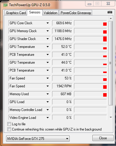

    What does GPUz say? I can't really believe your card is nt working as its quite difficult to force one state by accident. " monitors is meant to this as stated. I would check your monitoring is working first.
    It should have three power states; funny its not even flicking between them.

    7,977
    508

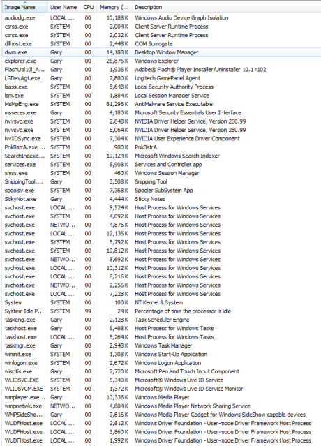

    and can we have a list of running process on your system?
    sounds like an application preventing it idle to 2D clock speed.

    Apologies for the gibberish in the previous thread. The GPUz is not touching anything for a few seconds? If so then your monitoring is sound and its definately the card or as WYX said its probably a prog.
    You could try uninstalling all you OC apps and then restart to see if it downclocks; they could be responable.

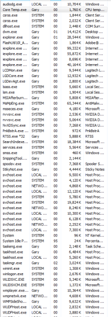

    what is FlashUtil
    close IExplore (Flash adverts)
    not sure about NvxDSync
    what's between spool and svchost

    BLIMEY that's a lot of stuff you've got running.

    Yeh there is a lot going on there, I don't know why I always seem to have so many processes going.
    The only things that are running apart from the norm windows stuff, is MSI Afterburner, Logitech LCD manager and Core temp which I don't actually need, was just using it to check stuff.
    @Wuyanxu that item is Stikynot, Sticky Notes for the desktop and aparently NvxDSync
    is something to do with Nvidia.
    Not that its really related to my present issue but how many processes do people normally have running?

    Bit more detailed snip showing what the items are.
    I don't ever recall this graphics card clocking down :(.
