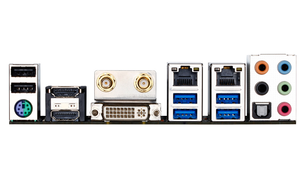

    After trying a buttkicker then recoiling at the price tag I'm really tempted to give this a go, maybe with three speakers, two in the base and one on the centre back (my spine) of the chair?!
    Could I ask if you need the external sound card? I always thought you could get one of these ports (image below) to do bass, I've never had to try though. So Motherboard integrated sound -> Amp -> Pucks.
    I'm a novice when it comes to amps and have no idea, does the speaker load have to be:
    a) equal or less than the amp rating?
    b) equal or greater than the amp rating?
    Also since your running the pucks in parallel I assume each can only operate at 50% power, do you ever max the "volume" on the amp?

    I don't know if your soundcard can output the subwoofer alone or not - totally depends on the software. Mine can't so I have to use a 3.5mm splitter. Because of that, the sound going to the pucks gets passed through an active crossover/amp to filter out the high frequencies. I went onto using the crossover/amp that comes with the Aura Interactor now instead of the original amp in my post. Its absolutely perfect for the job since you can vary the level of power it pushes to the pucks as well as the frequencies.
    Power wise, you need to make sure your amp can handle 25w minimum per puck, so for 3 - 75W - I'd suggest 100W even if you are running just two. The other thing you need to look for is Ohms. There are two types of pucks, 8 and 16ohm. Depending on which one you pickup, you have to make sure you are wiring your pucks in either parallel or serial to match the amp output. Mine are 16ohms so I have to wire them in parallel because my amp is only 8ohms. If you want to do 3, then you'll need to take that into account. It sounds like its very complicated but if you just do some basic googling there are some simple guides out there.
