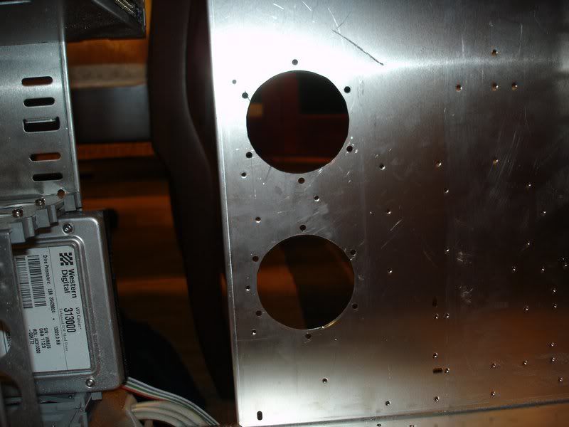

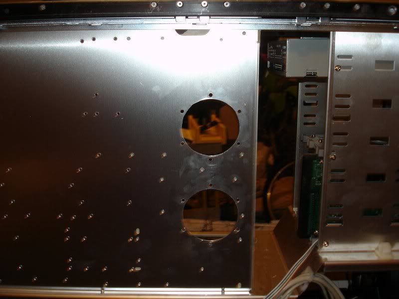

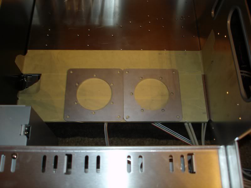

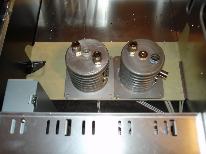

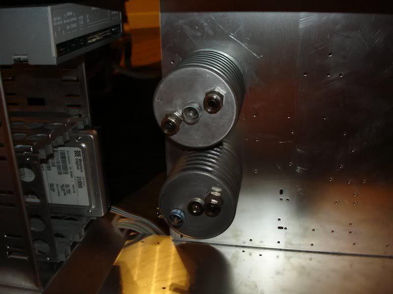

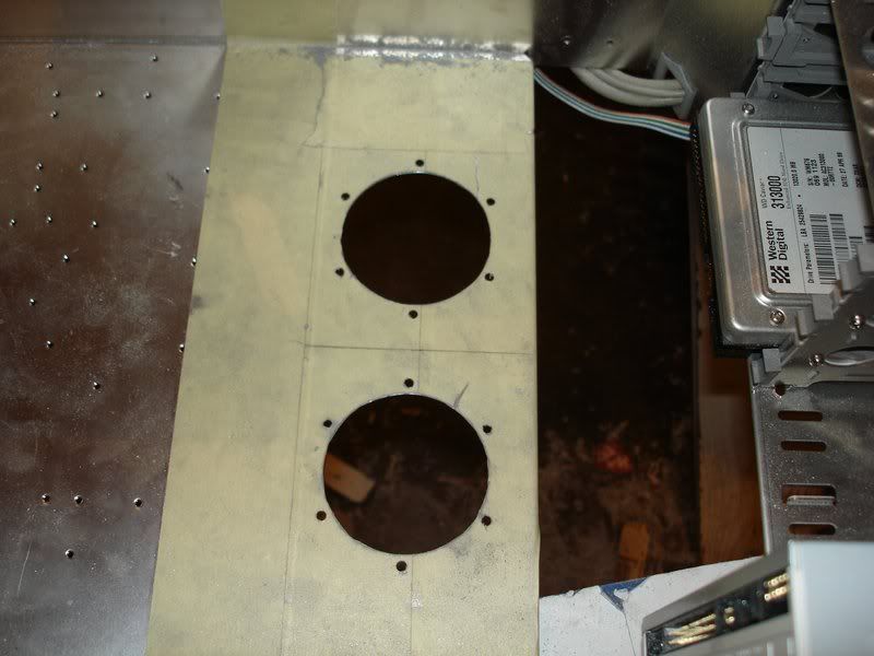

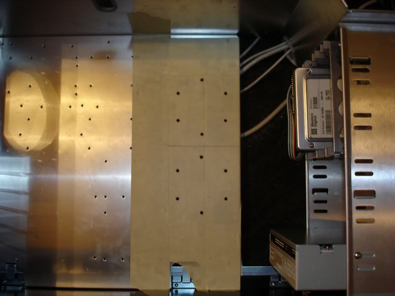

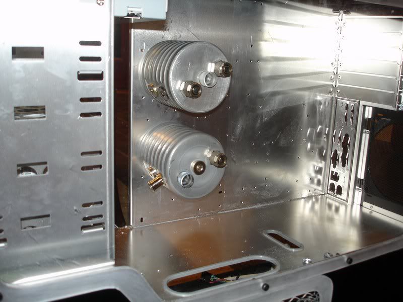

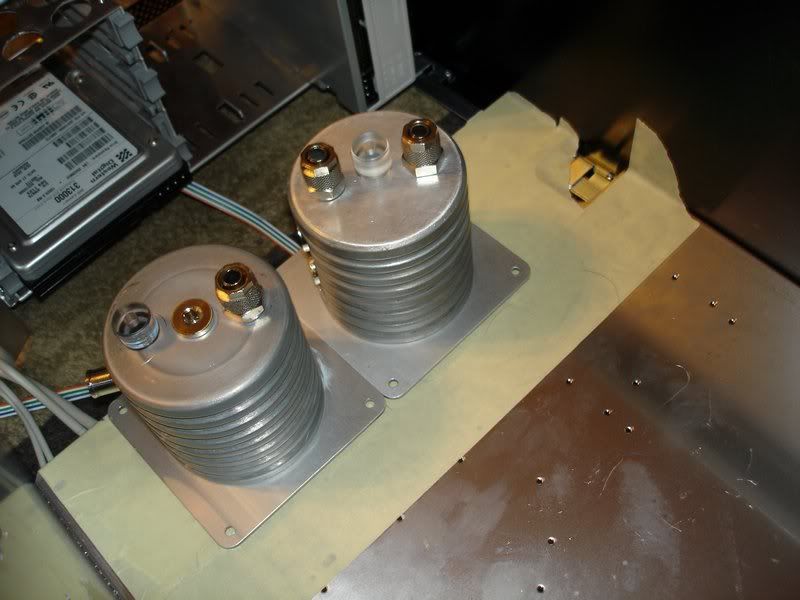

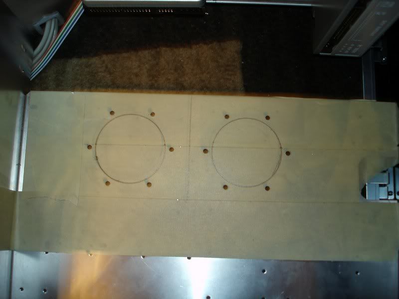

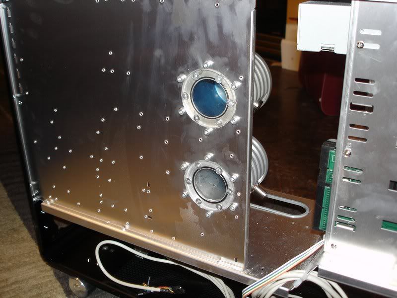

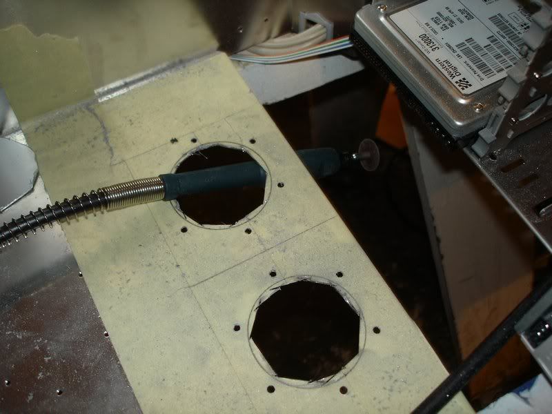

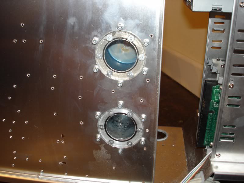

    UPDATE:
    I finished the res mounting so here are some pics.
    Test Fitting
    Useing the mounts for marking the cuts
    Mounting holes drilled
    Lines drawn
    Rough cut with a dremel
    After some filing
    From the backside.
    Frontside
    Mounted
    From the inside
    The progress shot with the window.
    another shot

    Wow - So thats why your having a case window on the other side aswell!!!
    What did you use to file the cuts with to get the perfect circles - just the dremel? Anyway - keep on going, can't wait till next update!! :D
    Edit: Did you have the hard drive in when you did the cuts - but unsafe if you did, i'd check if its still working.
  9. Fozzy
    Fozzy What's a Dremel?
    25 Jan 2005
    1,413
    I started the rough filing with a dremel cutoff disk and a steady hand. I sanded up to the line. Then I slapped on one of the plates and finished filing by hand. (It did ruin the one plate I used)
    Also the HD is a spare/dead HD already. My real HD is safely tucked in my ther case.

    lots of people seem to have 2 res in there systems do you need 2 or is that for show
  12. OldY
    OldY What's a Dremel?
    10 Mar 2006
    328
    If you put two reserviors into one watercooling loop, it would hamper on the flow rates and temps, and in the first post he said it will have two loops. I wouldn't recommend two reserviors in one loop although it is possible, it may render the watercooling useless.
    Hope that helps.

    A single res will only hamper performance if the pumps are unequal or the res simply can't feed them. I'm looking at feeding two loops off one res, but I'm also going with a low-flow system. With something like that, a lot of the normal problems get negated and different, more interesting configurations become available.
    Back to the thread, it's a little early, but it looks interesting...

    I'm running two seperate loops like Oldy mentioned. One for the video card and one for the cpu. Yes I could use one res but I think two looks better and it also means that I can fill and bleed the cpu and the gpu seperately if say I got a new socket motherboard or a new rention styled videocard.
    Another reason for useing to reserviors is the fact that after a period of time the temperature of the water equalizes to a certan temp. This temp is based on the load and unfortunately heats up the coolest chip in the loop while somewhat dropping the temps of the hottest chip. If I were to have a 226w pelt and an 80w pelt it would raise the temps of my gpu even though it has it's own radiator.
    Another reason yet is that th res is very small and even on one pump, on an even more restricive system, there were bubbles in the loop. I have a feeling they will cease when useing a system with all of the same barb sizes but It still needed to be considered.

    What pumps are you using for that? That may be part of your issues right there...
  17. Fozzy
    25 Jan 2005
    1,413
    MCP350's the problem is that the pumps are waaaay powerful. In fact I have no doubt in my mind that one pump could run both radiators and both blocks out of one res without any problem at all......but 2 pumps is more badass.

    Look at a pair of DD MAG2 LEs. Smaller,slightly less powerful, but far less likely to do stuff like outrun your reservoirs. And they're easier to place.
  20. Fozzy
    25 Jan 2005
    1,413
    You'll see soon that in my case it's easier with the MCP350's. Plus I'm mounting the barbs differently too.
