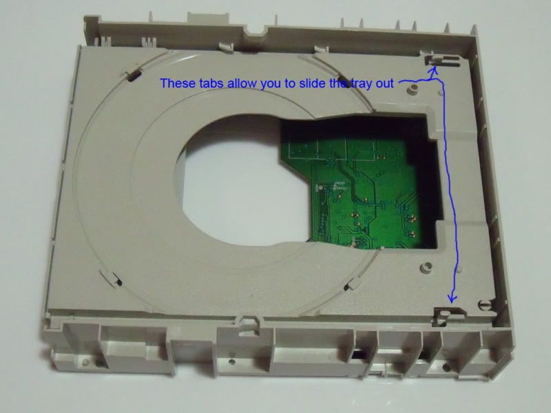

    I dont have any pics unfortunately, the screens were installed many years ago at my old work. I can show you these simple pics of an already gutted cd-rom i took for someone else asking the same question on a car forum:
    These pics show how the drive will look prior to riveting on some brackets to hold the screen in place on the tray. Hope they help.

    That`s sooo cool! But then the LCD would only "eject", with the surface facing the roof? Could you make a guide for this, i know a lot of people would like to try this on in their car or computer!
