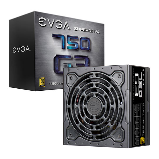

    The problem with SFX PSU's is that they typically have short cables that wont stretch in a full size case without extensions. Replacement cable sets are possible but are a good percentage of a new power supply.
    I currently have a corsair SFX in my other one of these cases and I need to use extensions (which are bulky).
    This is what I am going for:

    My build is finally complete and has been running for a few weeks. I couldn't find anywhere to post a build summary that's not a full hardcore mod log, so I will post a couple of pic's here. The build quality on the G3 is lovely.
    The G3 fits in really nicely and as I didn't need all the additional cables (only a single 8 pin and a molex) it wasn't that much of a squeeze.
