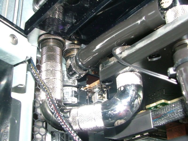

    Then, I was never happy with the rear bracket where the tubing passed from the lower GFX-card area, through the 'floor' to the CPU-area.....this was the original bracket, which I modified to accommodate the BP-fittings:
    and here it is mounted after modding:
    I decided to manufacture a new bracket out of aluminium, and use BP pass-through connectors to do a better overall job, and it came rather nice. I do not have a photo of making the bracket, but it is a simple piece of angled aluminium, drilled/brushed/finished and fitted.
    You can clearly see the new layout in these shots:
    and from below

    Just a shot from tha radiator-area, showing how tight things are with the motherboard power-connectors et al - I will replace all this cabling with individually sleeved wiring/plugs......
    A more clear shot of the new rear bulkhead connector plate, with BP bulkhead connectors
    And a close-up of the same - I have used spring-mounted screws to allow some flexing if required....
