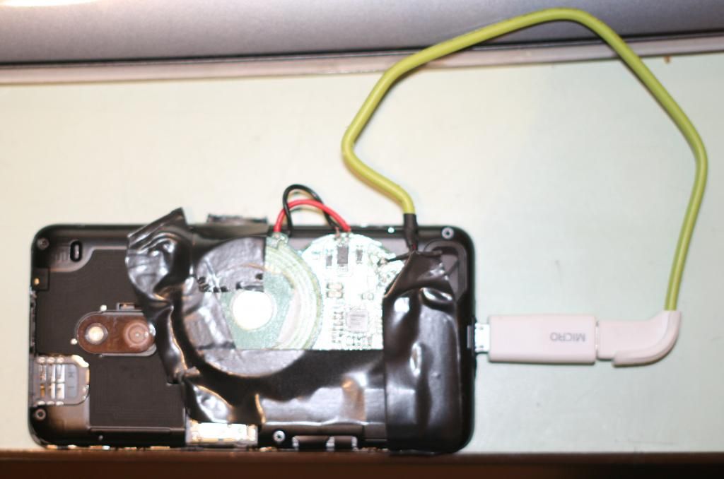

    Well one thoroughly chopped up and soldered together powercube later and I can report that the phone will make calls and both send and receive txt messages and e-mails.
    I can only assume that it'll make calls but no-one ever calls me (forever alone?)
    Phase one is a (horrible black electrical tape bodge of a) success.
    Thickness of phone with back, 12mm, thickness of phone without back but with inductive charger 11.25mm... it's going to be closer than I thought...

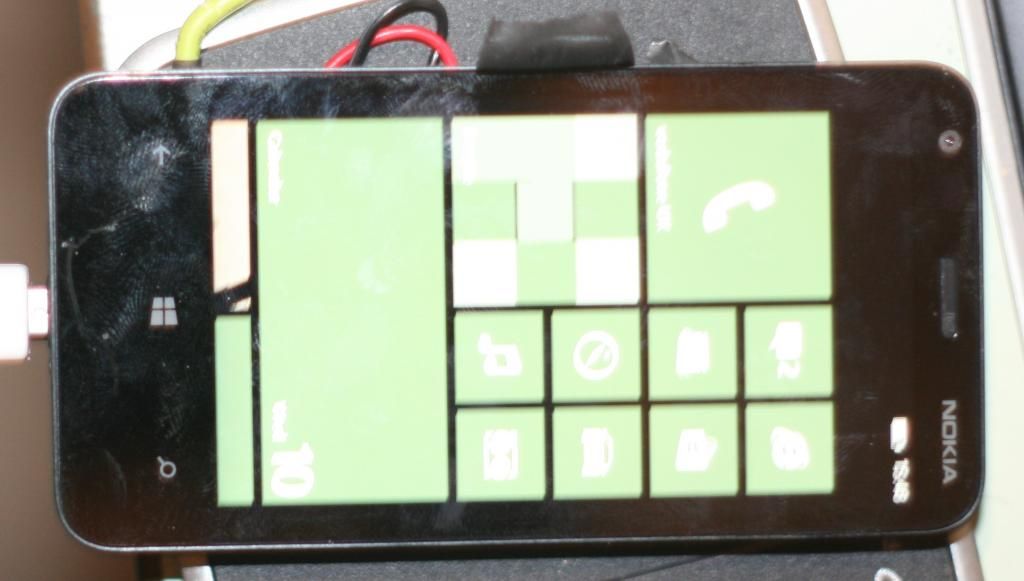

    Gahhhhh, the flash, it burns my eyes!
    The currently ugly back, don't worry about the overlapping, the second disc (they were both stacked and soldered P2P) will have its excess area which is currently under the inductive loop trimmed off.
    And..... charging....
