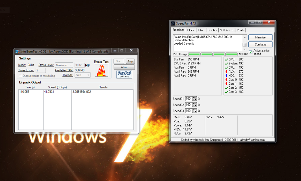

    Does this look ok to everyone? Temps ect?
    Also is it normal for CPU fan sp spin up yet the case fans stay the same?

    Yes to everything....lol
    Ok then. the CPU fan is controlled by the mobo and CPU temps the rest of the fans are at a fixed speed.
    The temps are fine, not running hot at all.

    i dont think speedfan is reporting your system fan and aux. fan 1 speeds correctly :D
    yes those temps are OK, but you should run more than just 2 passes of burn test if you want to stress your rig. your CPU temp will climb over time as your case temp rises. eventually everything will plateau, and its good to know what your "worst case scenario" is.

    How come? I thought they would have spun up abit as the computer got hot just to move the air thru faster, they plug into the modo after all.

    because if they were actually spinning ~350RPM, they wouldnt be doing a darn thing for cooling. probably more like 1,350. its been my experience that a lot of the time, system fan headers get misread. your CPU fan is the important one anyway and that seems to be reading correctly.
    but, as jeff pointed out, your case fans will not change speed based on temperature. only your CPU fan does that. the other fans plugged into the other motherboard headers will run at a constant speed.
