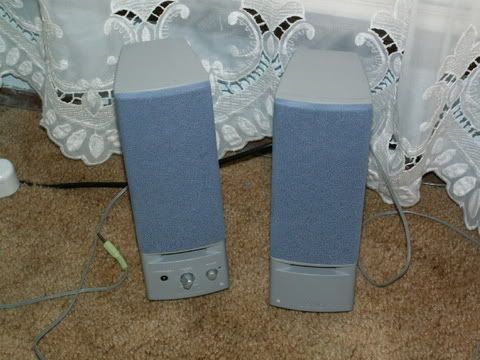

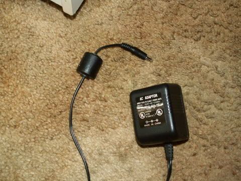

    [​IMG]thats the speakr[​IMG] and that is the power cord, can i cut that and connect to a 12v battery? its um my sony vaio speakers on the back of the speaker it says DC IN is 12v
    and i think the speakers are 3watts

  4. tm36usa
    tm36usa What's a Dremel?
    21 Jan 2004
    1,593
    They should be alright, just dont get the polarity mixed up.

    whats polarity? oh im making a portable sub/speaker system putting 2 6x9's and 1 10" sub :) so u think it would work? and do u know whats that cylinder lookingg thing near the end of the plug for?

    polarity is the + and - parts of the wire, if you mess it up it wont work (and you can damage your speakers.

    my suggestion to you (since you mentioned a laptop i assume you want this thing portable) forget about the subs entirely, if you want good sound go pick up a decent pair of headphones. not the two speakers in the picture, you need to fine wich side of the power wire is + and which is - (for example the wire attached to the innermost part of the power cord is + on your speakers) then go to radioshack and buy a bag of 9V battery clips.
    solder a 9V clip onto the end of your speakers (observing polarity)
    you should be able to power those speakers off a 9V battery, ive done so before with simmilar speakers :hip:
