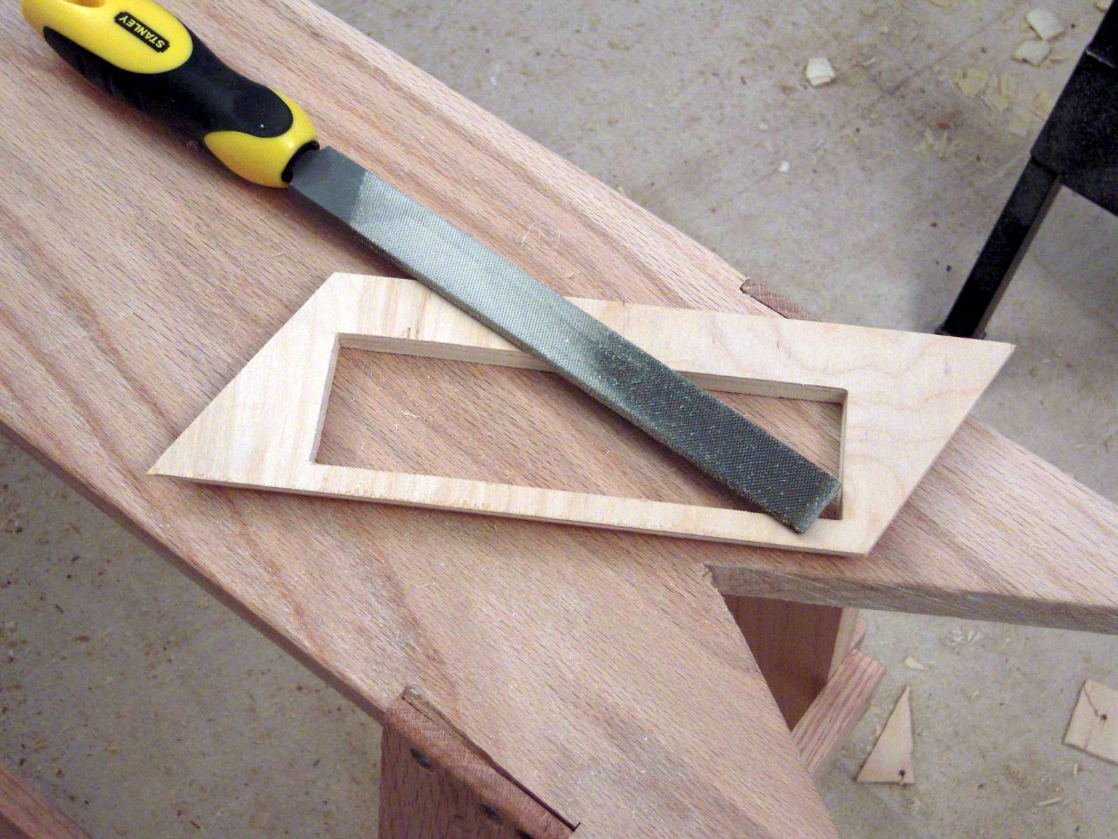

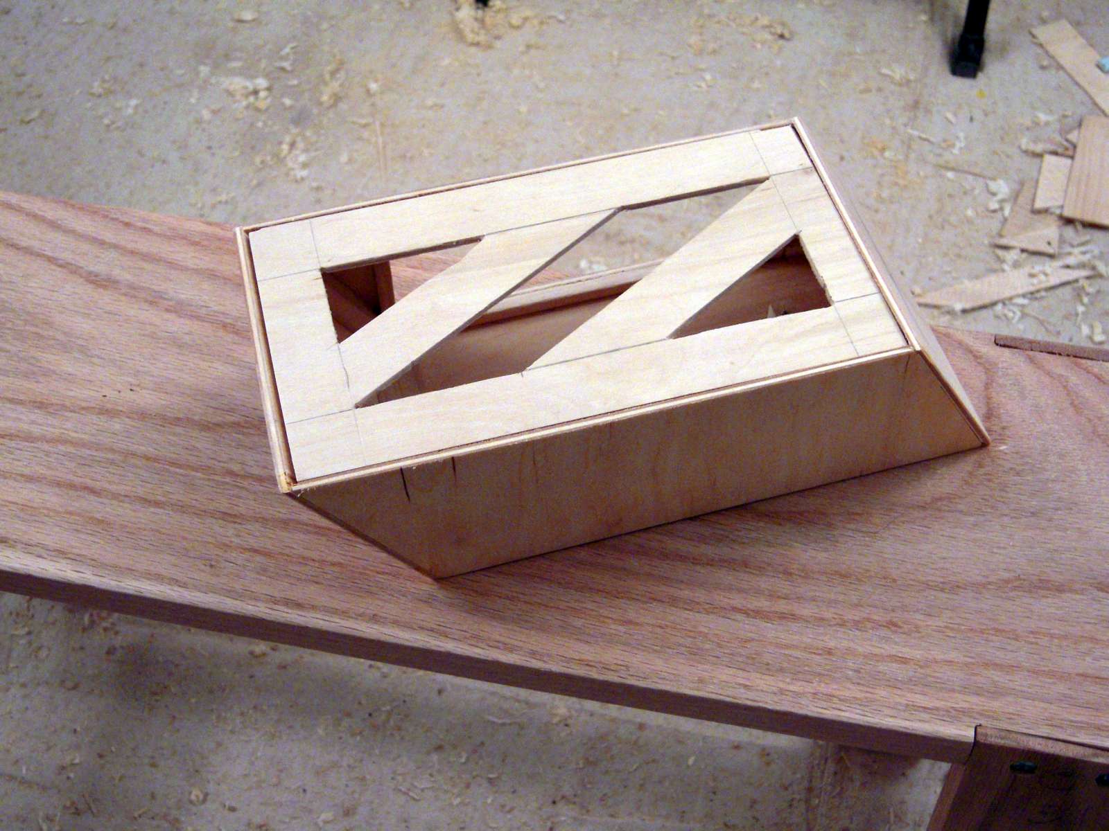

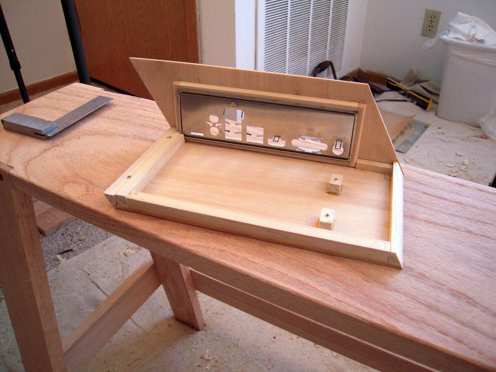

    Ok, it's been long enough since I did a computer case... I was waiting for my RasPi to show up, but in the mean time, another little system I was watching came up for sale before I got my RasPi. This is an APC motherboard. It's Neo-ITX. SlipperySkip did a pre-release case for it a little while ago. I wanted to build a case, but I wanted to do something different. I didn't want to be too similar to other things I've seen so I came up with something I like, and set off...
    And speaking of setting off...

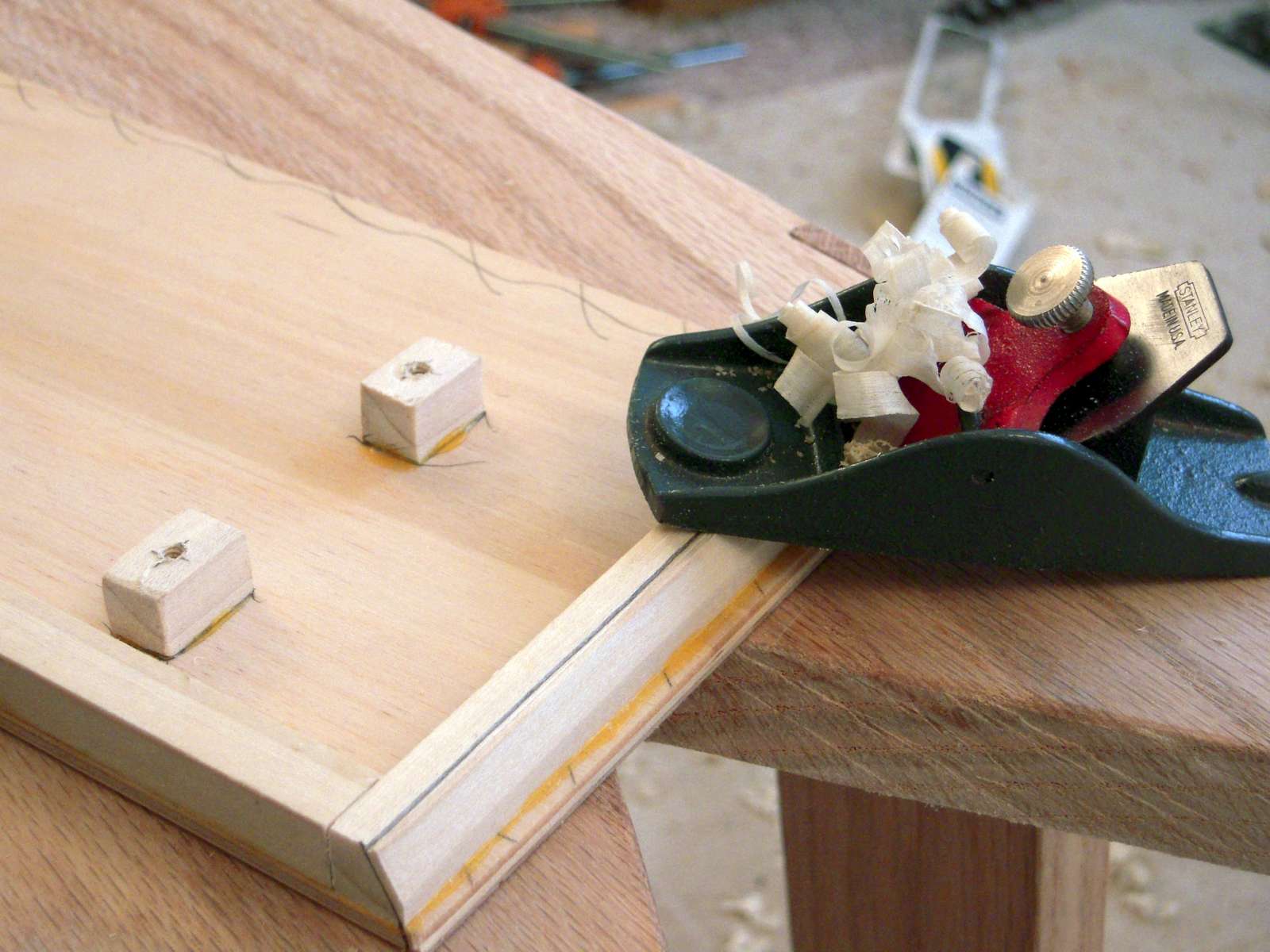

    Used my little Stanley 101 block plane to knock off the corner. It's such a fun little plane, I love using it. It came from my grandfather, and I just cleaned it and sharpened it up a bit.
    That's all I've got to share for now. Thanks for checking it out :dremel:

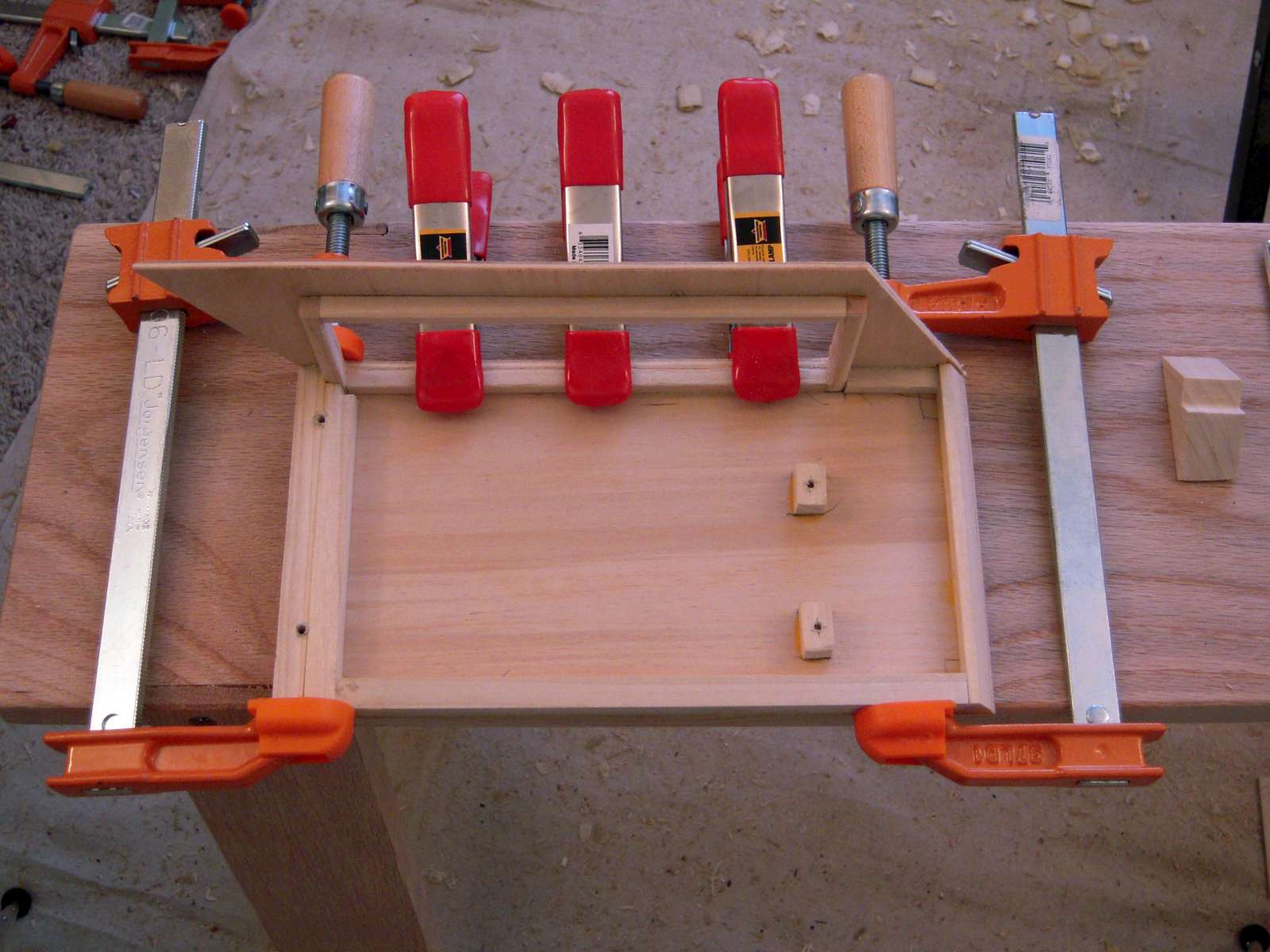

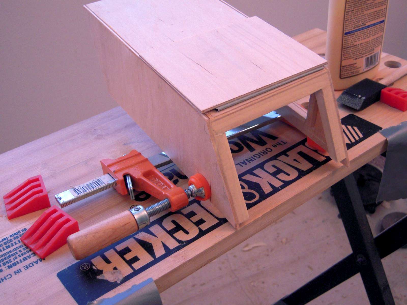

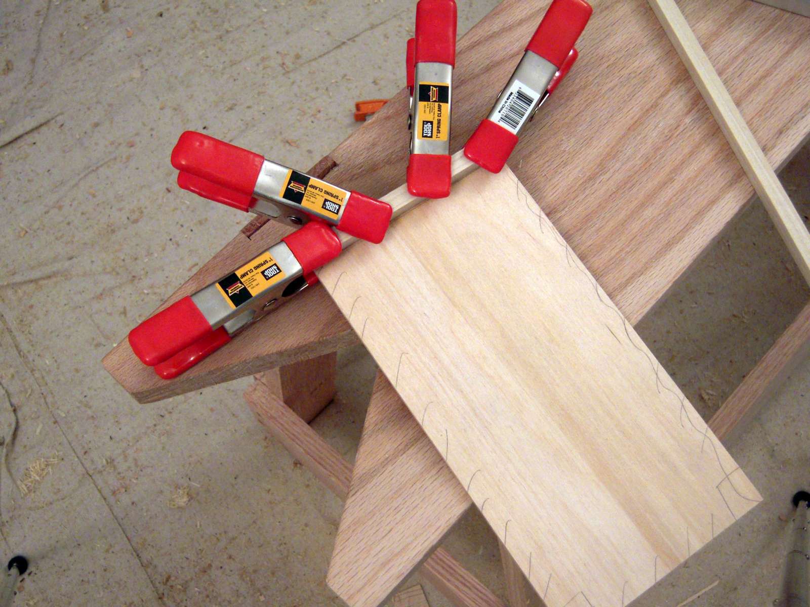

    Update 30, Aug 2012
    A few more pictures of progress.

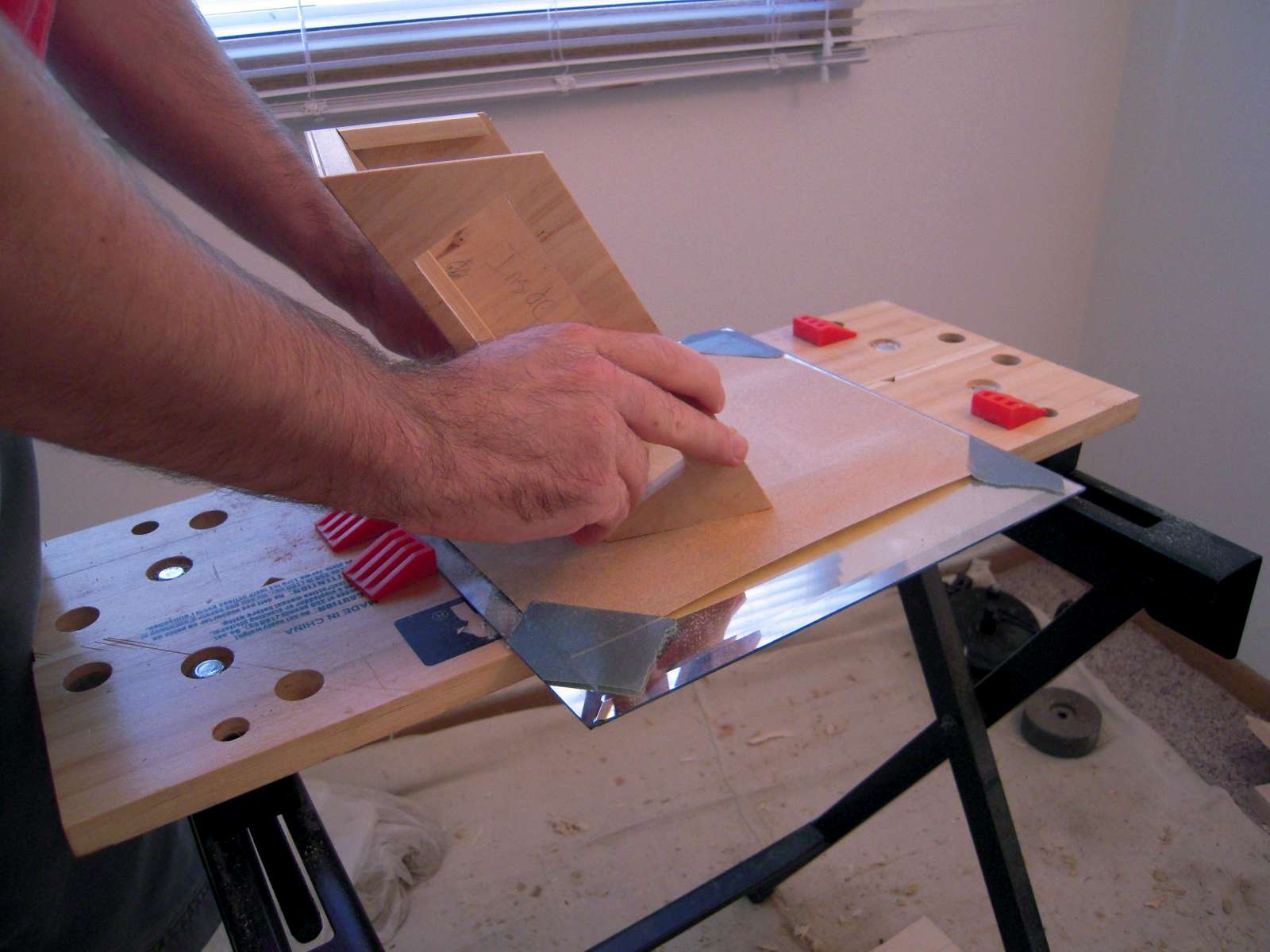

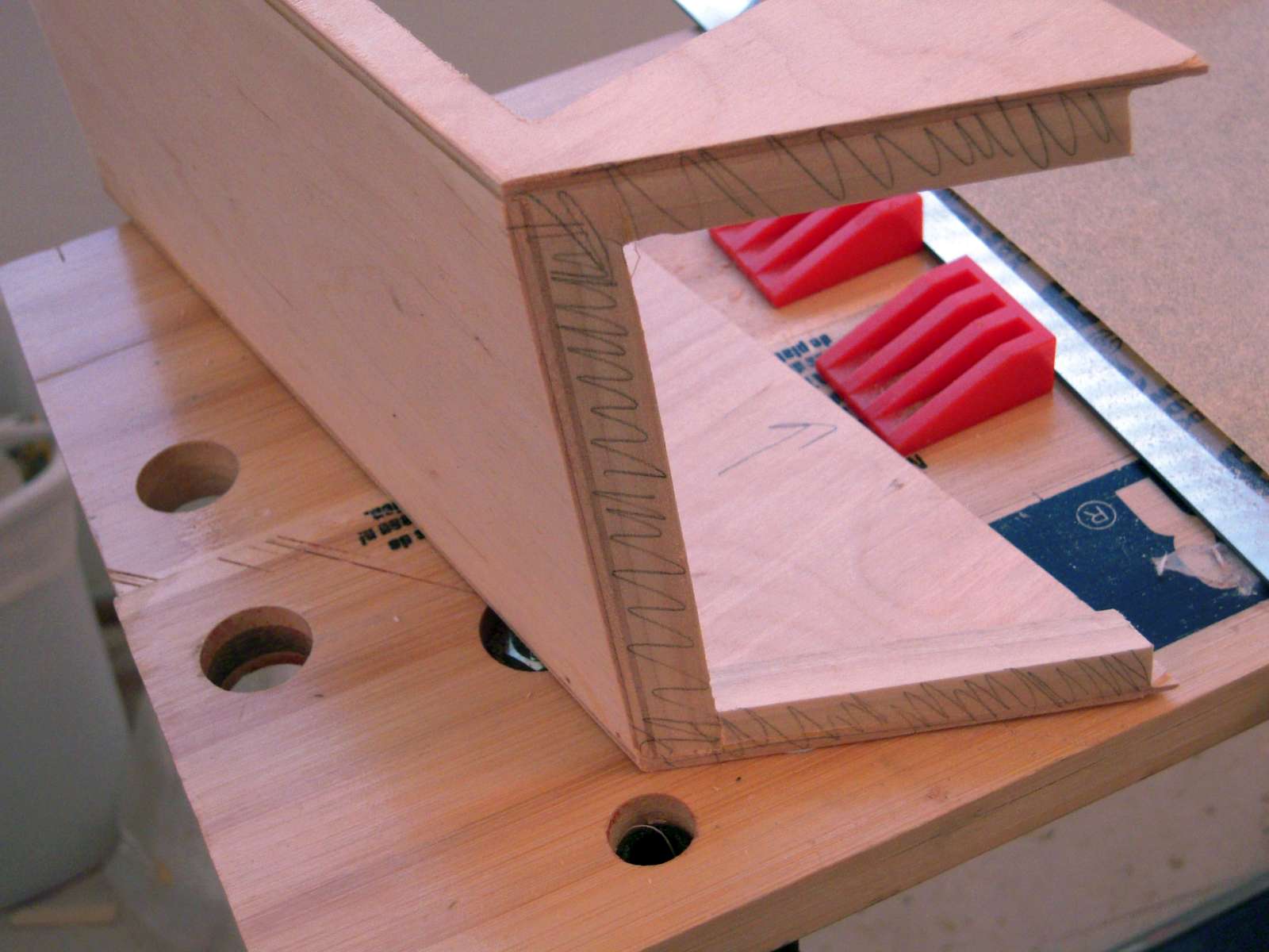

    Here I made some marks on the gluing surfaces so I could make sure I sanded them all even
    And this is why I did it. As you can see, it wasn't all flat after gluing (to be expected)
    I also glued in 2 supports for the top piece as well

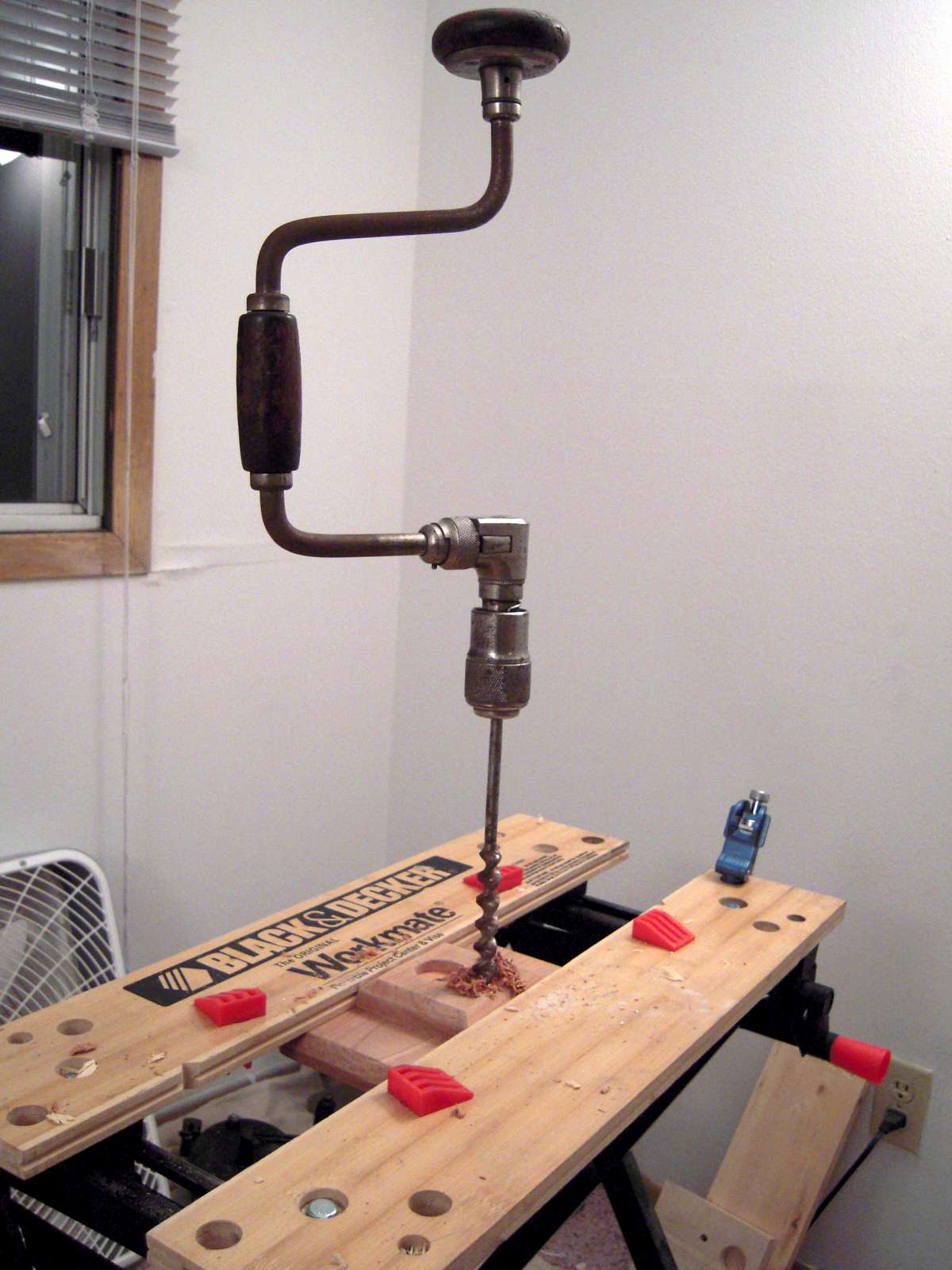

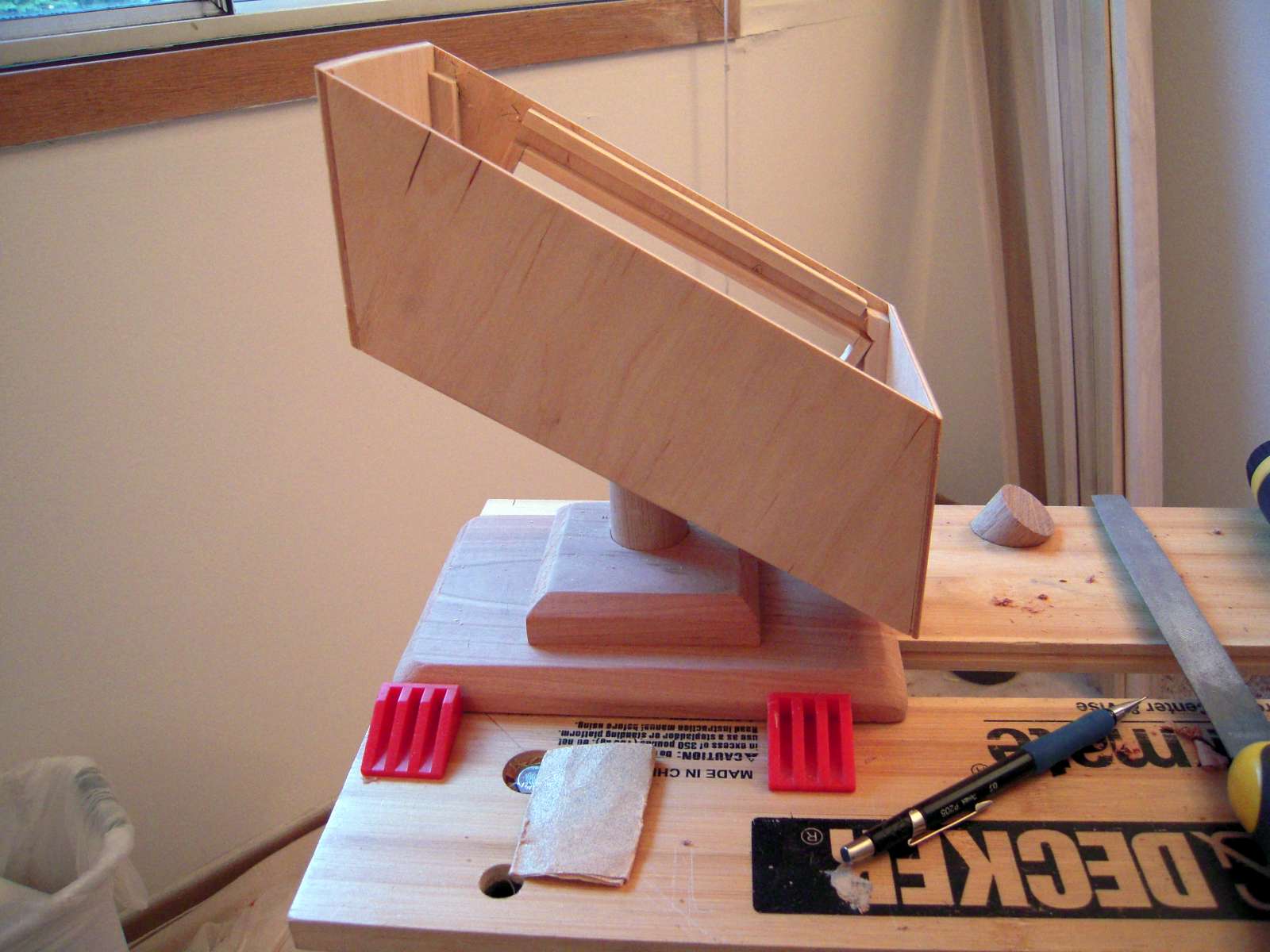

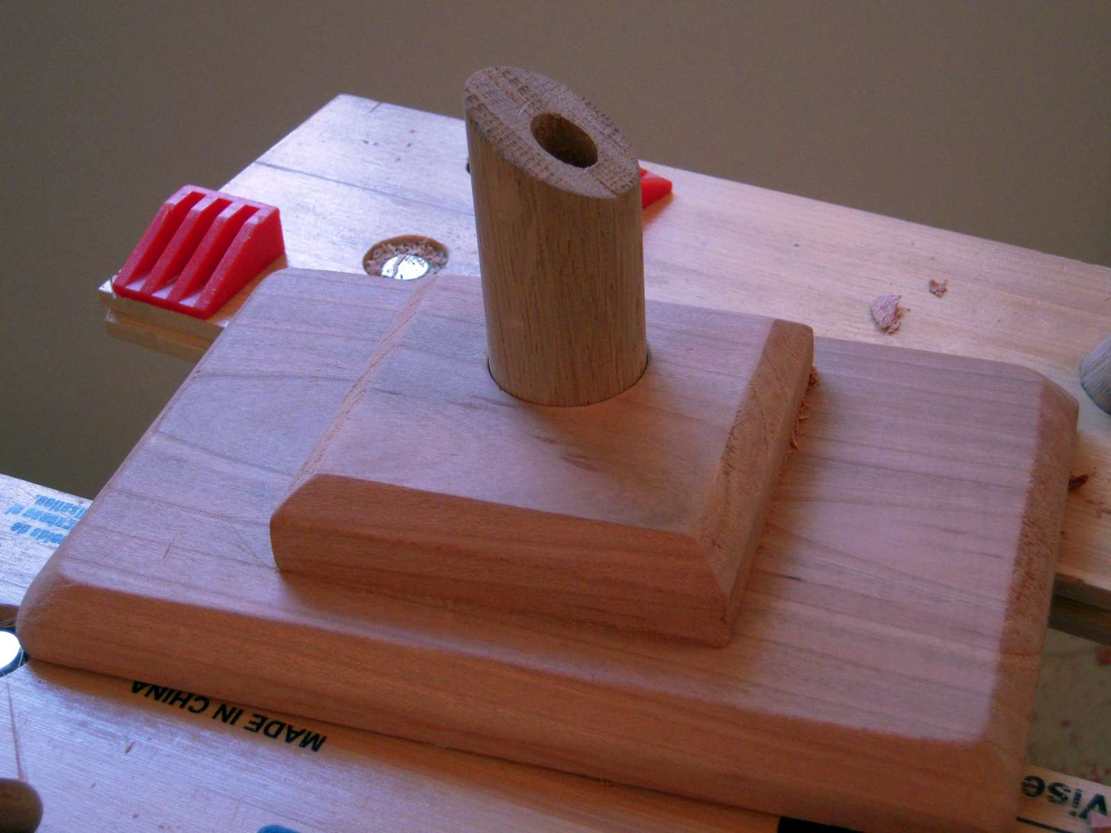

    Update - 4th, Sept 2012
    I found a little bit of time this weekend, so I decided to get a little work done on the case.
    I spent a little time with the little block plane again to chamfer the edges on some cherry to make the base.
    I then cut a piece off a large oak dowel at the same angles as the sides. I cut it by hand, so I was quite surprised with the results on my first try.
    About as close a match as I'd probably ever get by hand, with out a miter saw.
    And finally, I drilled a hole through the oak dowel, and made a recess in the cherry for the dowel to fit. I used my bit and brace for this, so as to keep with the lack of power tools. First time I used my adjustable width bit in my brace... Not sure I'll do that again, I think next time I'd just go with the forstner bit in the cordless drill :lol: The 1/2" hole drilled in the oak wasn't so bad, but the 1 1/4" recess in the cherry was more on the annoying side...
    It's taped for now, so I could mark the outline of it for drilling holes later.
    Thanks for checking it out. Hope to have more later this week.

    Thanks Austin, I intend to go with my original plan, but it didn't quite fit as would have been ideal, so I made the 2-tier base. I would have already done it, but the bit for my brace in the correct size was not sharp at all, so I have to sharpen that up before I get to it.

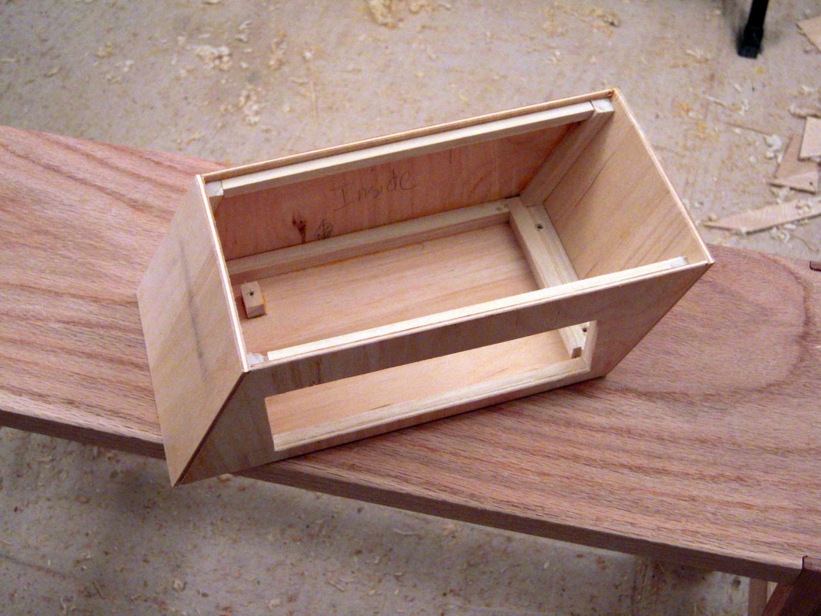

    Update 22, Sept
