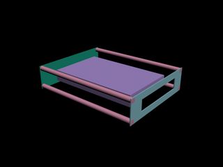

    I have been thinking about a similar situation involving a computer harddrive into a car (for a car pc of course :D ). This past weekend i came up with a really cool idea!. Basically you need two pieces of aluminum/steel/acrylic sheet, and some plain aluminum/steel rod. Not to mention some type of flat rubber product (maybe a cut up timing belt?)
    Heres a quick 3dsmax render of what the unit would look like (about the same size as a cd-rom but a little wider.
