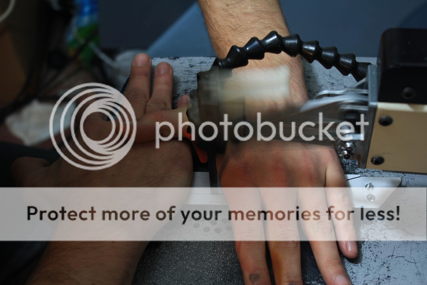

    Progressed a very good bit for the feet, all I need to do now is 5 drill hoes going about 7mm into the plates ends but then I need 6mm aluminium rod, I could buy some or I could sand down the 1/4 inch rod I have, cut a few pieces & JB Weld them in place & these feet will be rock solid but I'll save the JB Weld for after anodising. ;)
    Also then need to do some well placed holes for mounting the front plates & then mounting holes for attaching to the bottom panel.
    Did these 2 yesterday.
    Completed the other 2 today so that's the set, next stage for these 4 pieces is a big filing session to get the angles how I want them.
    Last 2 side legs.
    Drill helper in action.
    Finishing the holes to desired depth.
    More cutting.
    More sanding.
    Ta daaa, interlocked. :D
    Parts pile grows again. :)
    I'll see if I can get the feet completed tomorrow, thanks for looking. :)

  3. Achron
    Achron Cad Pro Quo
    28 Nov 2009
    378
    48
    ACK! Bad Waynio!
    Scroll saw or not, putting your entire hand in front of a blade is bad news waiting to happen. Hopefully you weren't actually cutting here and just staging a picture...right? RIGHT??
    :D
    Keep your limbs, bud.

    :D Yeah, bit risky but the only time I cut myself with the scroll saw was when a fine blade snapped & when I went to brush off the dust it sliced my hand open, tiny bit of the blade that snapped off was poking out a tiny bit, it got stuck right into my finger & oh wow it was a git to pull out but managed it, was like a fish hook completely in, ouch. :lol:

    Nah, Achron has a point. If the blade snaps it can stab you 30 times before you react. Clamps, a stick of wood, and scraps from the same material for spacers make a better hold down.

    Good tip, thanks cheaps I know Achron has a good point, I should edit the photo saying don't do it like this, I'll do it ASAP. :)
    Done. :)

    Chain mail glove like packing house workers use is light but scary tough to bandsaws and jigsaws. Cheap and worth WAY more than lost pieces parts.

    You want to end up missing parts of digits like me? Chain glove like John says. Better yet, a stick.

    Ok, ignoring the hand vice of death :p its looking good :D I first thought your stack of parts was somehow one beeeg foot assembly, so I stared at it like a fool for a couple of minutes trying to figure it out before I realised it was just ... well stack of parts :D

    In my job, when I see people doing such stupid things as shown on the photograph, I have to give them an official warning. :sigh: But hey, what one does at home is his own business. :thumb:
    So I think guiding clamps would be a better solution ?? Or somthing like that. :D

    Cheers Pete :) on future cutting I'll show off my new glove. :D:dremel:
    Thanks Craig, I did get into the habit of using a brush but I lost it some how but dug out a nice fat paint brush & keep it next to me whenever doing stuff like this now. :thumb:
    :hehe: I'm glad people give a sheet while I have good functioning hands. :)
    I'll show my power glove on next cutting session :dremel::D but even just a couple of small planks of wood with a good rubber grip underneath to keep my fingers away from the blade but still keeping pressure on the work close to the blade would do the trick nicely, in fact that is probably the best solution. :)
