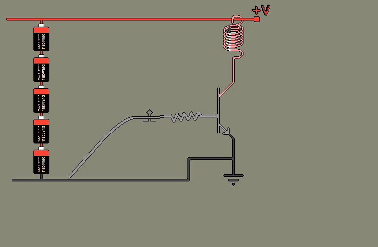

    LEDs are blue, with a fwV of 4.2V and 40mA...
    EDIT:
    I've came to a formula, in the kitchen, while eating, lol...
    It' s for transistor amplification...
    x is for transistor use (0.6V, as previously discussed)
    E = ( ( C * B ) / x ) - x...
    That means if you have 10V going tough the transistor, using 2V, having 0.6V drain, you have this:
    E = ( ( 10V * 2V ) / 0.6V ) - 0.6V
    so E = ~32.73V
    Is that right?

  3. SteveyG
    SteveyG Electromodder
    23 Nov 2002
    3,049
    8
    No, for transistor amplification you need to look for something called the gain of the transistor, either denoted by the greek character beta, or hfe. This is basically the ratio of Ice to Ibe.
    Diagram is looking better though!
  4. KDNenakh
    KDNenakh What's a Dremel?
    9 May 2005
    80
    Ehhhhhhh... Can you give a clear formula? As in how to actually calculate it without going all fuzzy up and down the characters...
    And thanks about the diagram, if that was referring to the circuit... ^-^
  5. theshadow27
    theshadow27 What's a Dremel?
    23 Sep 2004
    616
    it isnt realy something that you want to calculate, but rather something that a data sheet is good for:
    (for example)
    if you realy want to figure it out, your looking at something like:
    which is want SteveyG said... but i would learn ohm's law before you get into semiconductor physics :rolleyes:

  7. KDNenakh
    9 May 2005
    80
    More math:
    Current Gain = Ic / Ib (that is what you explained)
    Ic = Current Gain * Ib
    Ib = Ic / Current Gain
    Ue = Uc - Ub
    Hope that fits... now, I' m puzzled on what happens to the amps and the watts...
    Maybe anyone got a formula... after that, i' ve got all I need to get a figure of how the transistor works...
  8. theshadow27
    23 Sep 2004
    616
    the rest is right, but this:
    what are you trying to do? i still dont understand
    in that formula, Ic and Ib are both in Amps. Current gain is in neither Amps, nor watts, it is a term that only pertains to the ratio of input to output. it serves no other function in any other electronics equation. its only purpose is to quantify the maximum amplification power of a transistor, so that you don’t have to do the math in you head while staring at a datasheet.
    remember, its not too important because its maximum gain, not absolute gain. 99% of the time we are only concerned with the current capacity (sorry for not being explicit before, capacity not draw) of a transistor, and the base current is irrelevant. in the 1% of the time that we have a device that cant source enough base current, we simply add a second transistor to handle the base of the bigger transistor. this is called a darling array.
    if i am missing your point entiarly, please explain it diffrently
  9. SteveyG
    23 Nov 2002
    3,049
    8
    All those formulas are the same thing except for the bottom one. Not sure where you worked that one out from, but the voltages totally depend upon your configuration and transistor type.
    What about the amps and the watts? The current is what you've just worked out in those equations.
    edit: Thanks for explaining the rest theshadow27, saved me some time!
