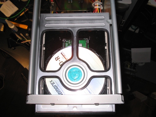

    I put 2 leds' in the DVD drive glued to the top of the case. Since its an ext drive I used the 5 volts from the usb (so when my pc is off, the lights are off) but now when I plug it in, it says the drive failed...

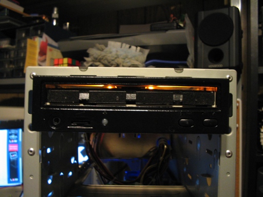

  13. led_zeppelinzoso
    led_zeppelinzoso What's a Dremel?
    13 Jul 2006
    184
    Done! how does it look?
    I told 3 of my friends that it was a Blue-ray drive, and they belived me, lol

    Looks great, clever calling it a 'blu'-ray :D
