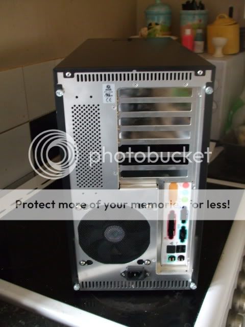

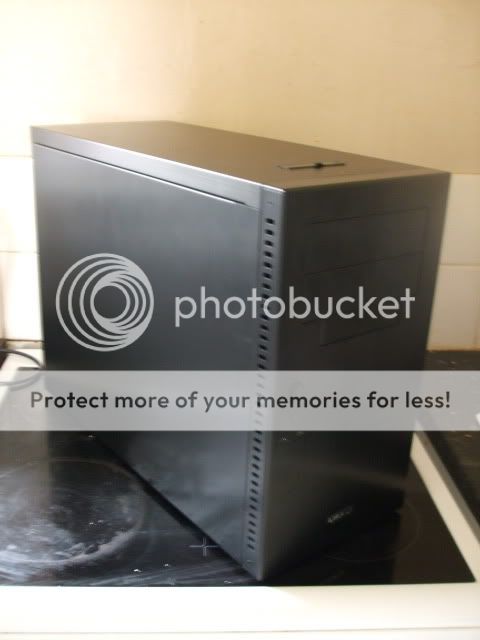

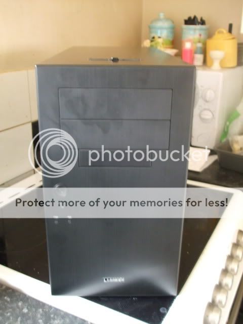

    It arrived a virgin. Brand new condition basically.
    Those are some snaps mayhem took before shipping.
