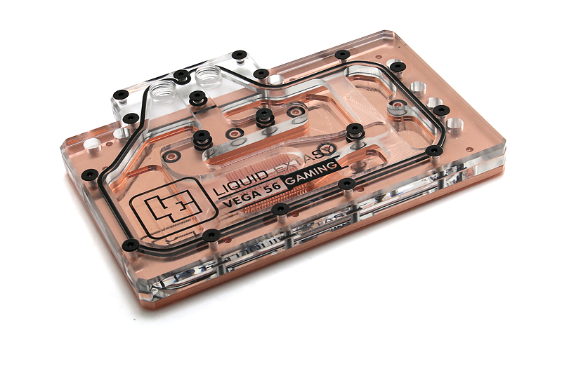

    At that time there was a platform that tested waterblocks on a special benchtable ( with a FET not with a real CPU) and tested waterblocks of performance. -> Watercoolplanet.de I sent them some waterblocks, which didn't do badly for the first time. With the Al_Vis 1.4 I built a cooler that made it the 2nd place in the ranking. Coolers built with just a Dremel, driller and file. More coolers and reports in the forum followed and I received requests for replicas.

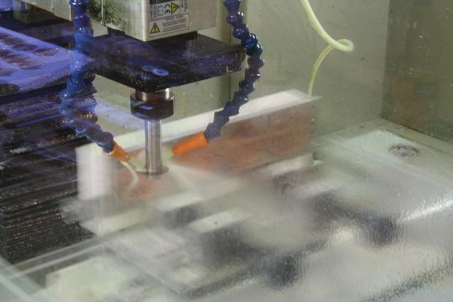

    But the productiontime take too long time for me, I removed the original spindlemotor of the milling machine and replace it with a Kressspindle. From then on, higher feed rates are possible.

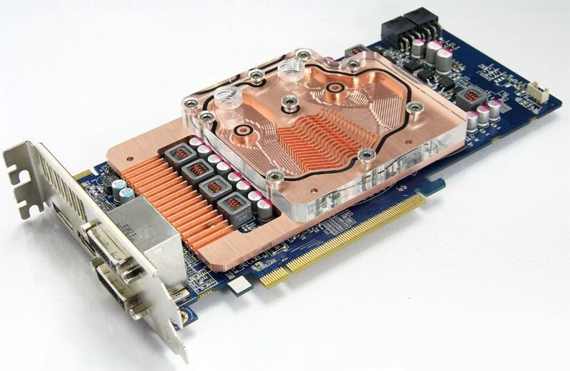

    Other coolers quickly followed, for example the Asus P5Q and Nvidia's 8800GT.
    In 2010 I changed the cooling structures of GPU coolers. -> HD 5870 waterblock. The cooler was created in cooperation with PC-Masters. Meanwhile, the interest was huge. I as a one manshow had released the most water coolers ever/year. Even the big ones like Aquacomputer and Watercool couldn't keep it up. 2010 was also the year I developed my first console water block. The Playstation 3 water cooler.
    Since the Kress router regularly stopped working, I switched to a more expensive millingspindle. Suhner UAL23RF. This made it possible to produce faster. However, only 10 months. -> Bearings broken L. In 2010 the first fullcover waterblock for motherboards followed. The Asus Maximus III. Furthermore, In 2010 dealt first with the topic of nickel plating.

    At about the same time I switched from wet milling to MMKS (minimum quantity cooling lubrication system) in order to keep consumption of the expensive coolant low. About 3-4 liters of coolant were lost every day on the large machine. I was able to reduce that up to 1/3 with the MMKS. The coolant no longer hits the tool as a "water jet", but as a spray mist. This was to become a major problem later on, which has still not been fully resolved.

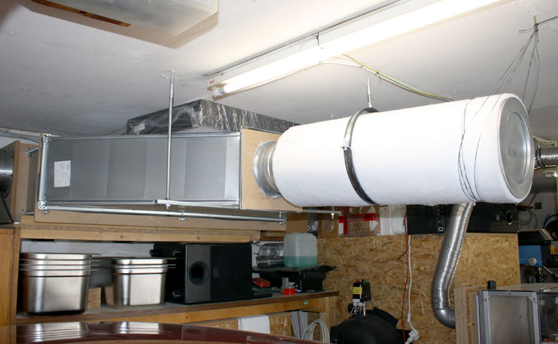

    Furthermore, I began to deal with the topic of air filter systems because the air in the workshop is heavily contaminated due to grinding dust and oilfog in the air. In retrospect, this is one reason for my pulmonary emphysema. And that in my mid-30s. I read a lot and also got offers from companies. A company build and airfiltresystem for €8,000. Unfortunately, the budget didn't exist. So the only option was to build it myself. I started with 200mm duct fans and vacuum cleaner filters. That brought a significant improvement, but I was sure that there was still a lot of space for improvement.
    At the same time, new milling spindles came in for testing. All spindles were put through their paces, but the most spindles were judged to be more bad than right. Other suppliers were sought and later found. The problem with many milling spindles is simply that the out of the box is not good. The cone angle does not fit on almost all spindles. cone accuracy is not good up to 50%. There are leaks, overvoltages, the spindles are not grounded, screw connections have been broken and rusty inner cones have been founded. You get what you pay... I sort out all my unusable spindles and only deliver excellent spindles to my customers. In 8 years there were only 3 complaints! Strange.
    January 2017 I started to manufacture and integrate the tool magazine.
    In the spring of 2017 I continued with the airfiltersystem. H13 as final filter should be good. Which was then quickly accomplished. In retrospect, the filter area of approx. 50m² is not too small. Because a volume flow of approx. 1800m³/h is required to filter all emissions. -> air exchange rate of approx. 18. That is not extremely high, but it is very high. Companies that offered to install an air filter system recommended an air change rate of 8-10. I would never be happy if I had this small air exchange rate. I also made a suction shoe for the milling spindle of the large milling machine, attached it and expanded the Z axis for another milling spindle. The spindle is used for dry milling. For example wood. -> Table tennis blades from the label Customblades.
    After half a year, I got along so well with my small HSC milling machine that you can create mirror-clear edges. However, my pace has slowly caught up with me. In autumn 2016 I had to officially stop the production. This still applies until today. Unofficially, however, production continues to the best of our ability. The already mentioned pulmonary emphysema is only one part of the truth. Accordingly, there are basically hardly any innovations from 2017 onwards. What I have created myself over the last 10 years will be expanded from now on and only very slowly. Especially since it has to be said that nothing has developed technologically on the watercoolingmarket market at GPU waterblocks. Existing cooling designs are only adapted to new videocards. However, there was an optical update at the beginning of 2018 where I was still able to use panels. It started with the RX Vega 64 water cooler.
    In March 2018 I started to deal with the topic of vacuum technology. After some testing, a good configuration was found, although the vacuum table had to be adjusted. All of my vacuum tables have 4 lines for suction and a 1" maintube to the vacuumpump. There is now enough airflow through the small holes of the vacuumtable and the parts remain taut even when large areas are open.

    The air quality was much better after the big update of the filters and the fan. It feels like it could stay that way. But I wanted more. Bad mistake. The active carbon filter is said to filter molecules by itself. odours, volatile solvents ect. Pp. That may be true, but the use of active carbon filters has deteriorated the air quality because carbon dust was blown out. So I had to remove the filter again
    In the meantime there are not that many updates anymore because my health has been significantly worse since mid-2018. Among other things, also by nickel plating. So I looking for good doctors and finally ended up in Erfurt, where the doctor diagnosed a heavy metal intoxication. After 15 DMPSA infusions, my levels have now normalized. I was primarily exposed to mercury and nickel. The 7-fold to beyond the limit., There was an urgent need for action. I hope I don't get lung cancer because of this. More great coolers have been released.
    In November 2020 I bought a particulate matter measuring device. The result without an air filter system was frightening. 576 particles/m³ 0.3µ particles in the air and only with 2 machines inside the cabins. With the air filter system, the value has dropped to 54 particles/m³. That means as long as the big machine isn't work, it's fine with the air filtration system. I also attached pressure monitors to each filter that let me know when the filter is full. Replacement of vacuumcleaneriltre to class H13 filters was also completed. With the Gigabyte RTX 2070, I greate a new cover design which is still in use today, provided the layout of the waterblocks allows it.
