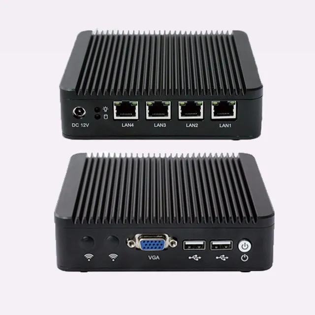

  15. Chunkers
    Chunkers Meat Popsicle
    24 Aug 2010
    100
    6
    For pfSense router, in my view, you want low power consumption and Intel NIC's so I would go for either a Qotom (linked in post above) or have you considered a PCEngines APU2C4 based routers, they are tiny and completely silent / passive with plenty of power for home network unless you have Gb internet.
    The PCEngines units are also super easy to assemble and are very power efficient (6W) so will save you money compared to PC hardware based units.
