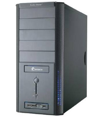

    I thought I should finally start my so called "work log"
    It's not much, it's my first mod and first watercooling loop and it's all very budget inside a Coolermaster Centurion RC534.
    I didn't have a camera when I first started this project so sadly you miss the pictures of it being stripped down and what not
    I started off sorting out my fans, they are Yate Loons and come with stupid 3 pin and 4 pin molex, wanted to remove the 4 pin a I wont use it
    Before:
    After:
    1: The case
    2: I got a shiny new TFC XChanger 120mm to cool my CPU and decided to mount it in the roof
