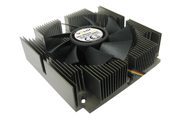

    Some more googling has found the Gelid Slim Silence iPlus which is a bit cheaper at around £20 but because its larger than the standard Intel heatsink footprint, Gelid have provided a drawing to check if there's any obstructions around the CPU socket.

    Just made up a template and thanks to you that one is a definite possible.
    Edit: Maybe not judging by a review I have just read.
