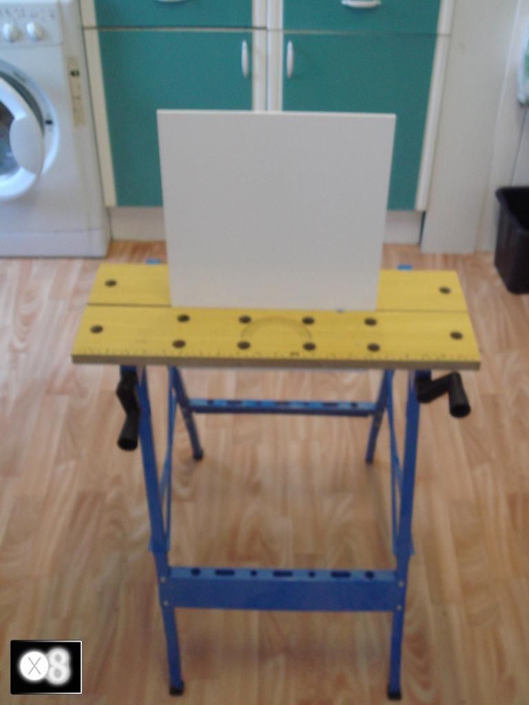

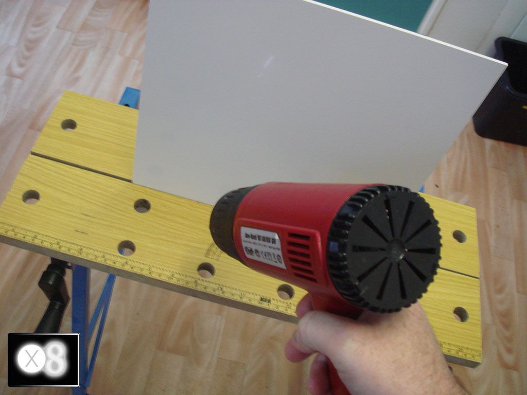

    Then put the thing in a workbench and put the logo under the bend. So like this -
    All you need then is a cheap heat gun. The bench I am using is made by Silverline and cost me about £14 delivered from Amazon. The heat gun was a tenner? IIRC and I used it solidly for about a year before the power switch broke so I took it apart and just wired it to be on as soon as you plug it in.
    Then you are not bending anywhere near to the logo and the logo is safely out of the way, locked under a 3/4" solid piece of wood.
    It looks to me like you are using 5mm acrylic which yeah, would be very hard to bend. For a PSU cover 3mm is ideal. It only sits there with nothing on it or over it.
