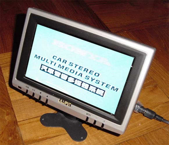

    I recently posted for information regarding an in wall media screen I wanted to create, some may remember.
    I was looking for information about how to go about this and what i need.
    I believe I have found a TFT screen I want to use now, and was wondering if this can be connected easily to a computer to be used as a media screen displays graphics, music information, eq info, etc.
    These are the spec's,
    7.5" Big Screen
    SUPER THIN Dimension: 209 x 144 x 28 (mm)
    NTSC / PAL 100% compatible with Eureopean (UK, France, Germany, Italy, Spain, etc) TV/Video and US Standard
    12V DC Power Supply (from 220/240V AC socket or Car power socket)
    Built-in Speaker
    Support RCA Video/Audio input
    Support PAL and NTSC auto switching
    Built-in Calender
    Brightness Control
    Contrast Control
    Color Control
    Sound Volume Control
    Sleek Remote Control (included)
    Monitor Stand (included)
    Thanks all
    Russ
    By the way, this has no TV Tuner (cheaper) but you can get it with a TV tuner too which I may do
