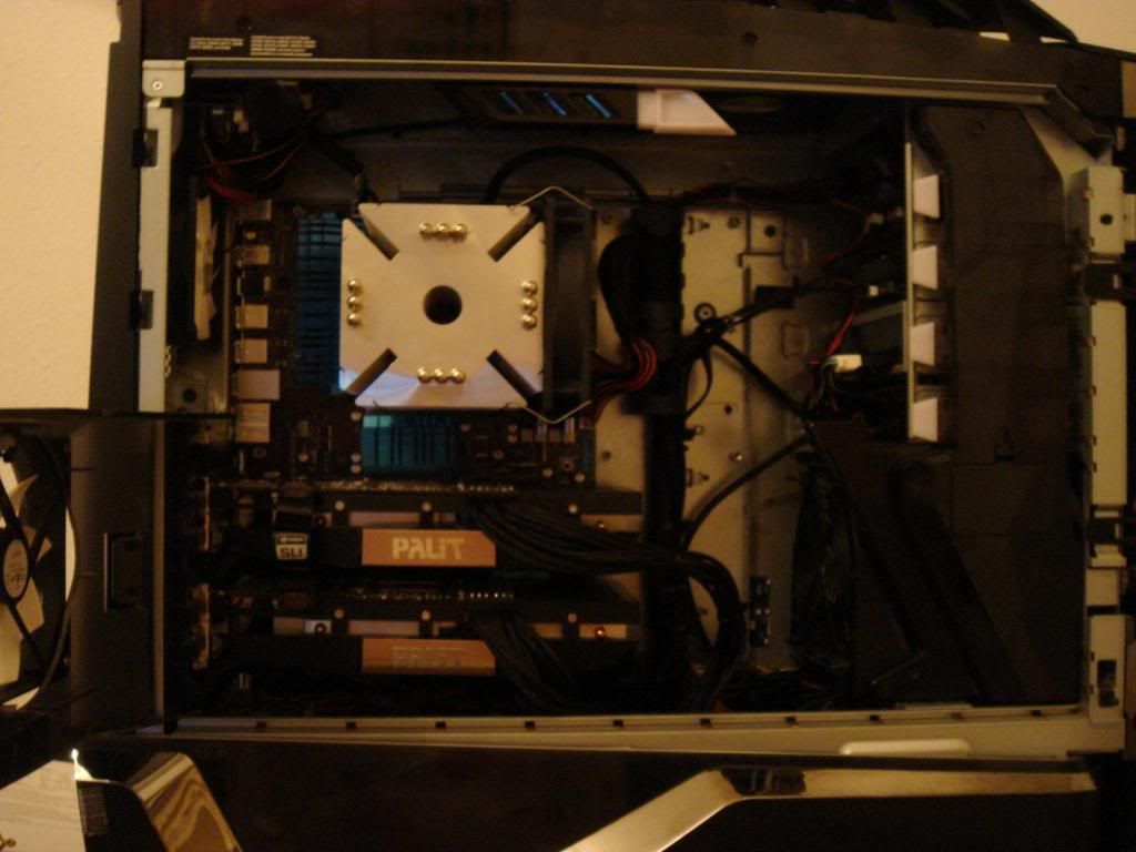

    It doesn't matter Sandy. HyperSLI will enable SLI no matter what bandwidth you have available. And I can tell you from experience (as I'm literally doing it as I type this with two 670s on a £50 board) that it barely matters.
    I actually scored higher in 3dmark. I lost 1000 points from Catzilla but when you consider my X16 X16 score was 15,000 it's a mere drop in the ocean.
    I truly can not speak highly enough of HyperSLI. I used to have a 990 board that I returned (it was £90) and ended up with the board you see there, £55 IIRC. Installed HyperSLI - sorted.
    I even ran HyperSLI on my 990 board at one point due to the way I had to lay out the cards because of other add in cards (I was forced into the X4 slot on the 990 board). Worked like a charm :)
