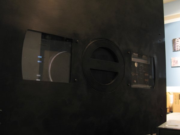

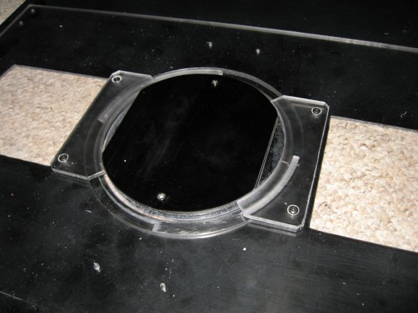

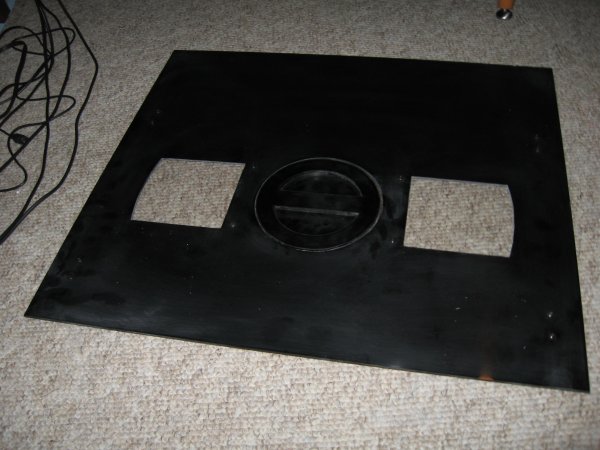

    I'm glad that you're building that side panel quickly because the 2d drawing is hard to visualize the spring action of the locking mechanism.
    Congrat on the progress thus far! It's really grown into something different!

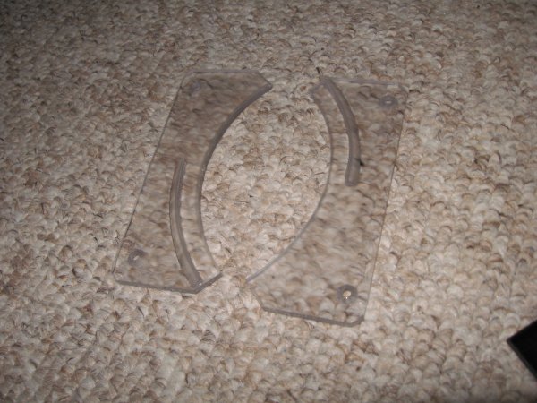

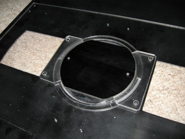

    I'm putting it all together in the morning. It will make sense then.
    It's actually very simple mechanically (only 2 moving parts), but not the easiest thing in the world to machine unless you have access to the variety of tools I do.

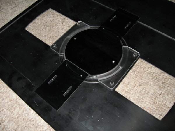

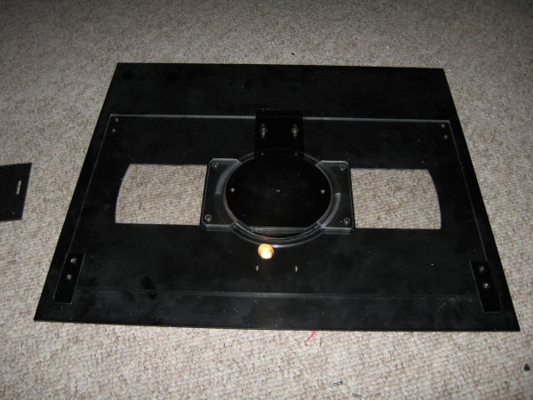

    Having two locking teeth wasn't working perfectly, but no matter because I had a plan B prepared. I also haven't added the springs yet because I forgot to rummage around in the junk drawers at work to find some.

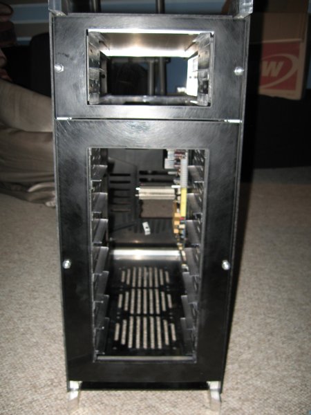

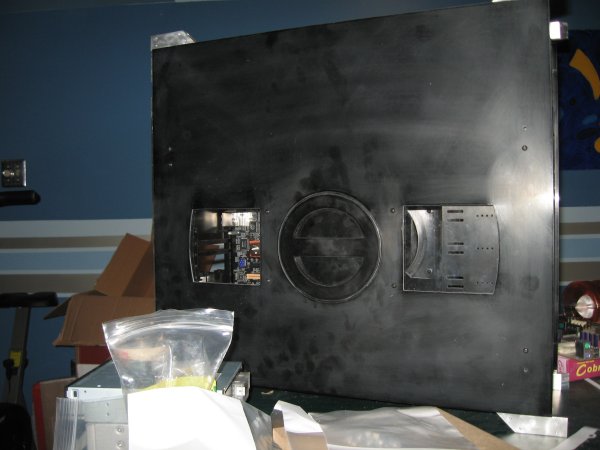

    I added threaded rods to the frame. The various trays now lock onto the frame using aluminum acorn nuts.
    The plastic is still pretty dirty. Way back in the thread I explained that all of the opaque black acrylic sheets will be sanded with 300 grit sandpaper to remove the gloss finish (I prefer a flat or satin for this project) and on the windows on the side panels will be left perfectly clear. I won't bother with cleaning anything until all of the parts are done.
    Tomorrow if it's not raining I need to put a barbeque together. I only have some tiny dimensional refinements to do tomorrow . The side panels are 1/8" too wide in both directions because I left wiggle room should I need to adjust for the fit on the motherboard tray and drive cages. I've already done everything I had on my list for this week except for the handles. Those I will get to in a week, along with adding the springs to the side panel mechanism.

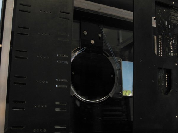

    The side panel mechanism is completed. I was going to use springs, but couldn't find any suitable ones at work. So the backup option of rubber bands ended up working better.
    Here's a video of the mechanism in action: http://www.youtube.com/watch?v=3tfXGXkNMMQ
