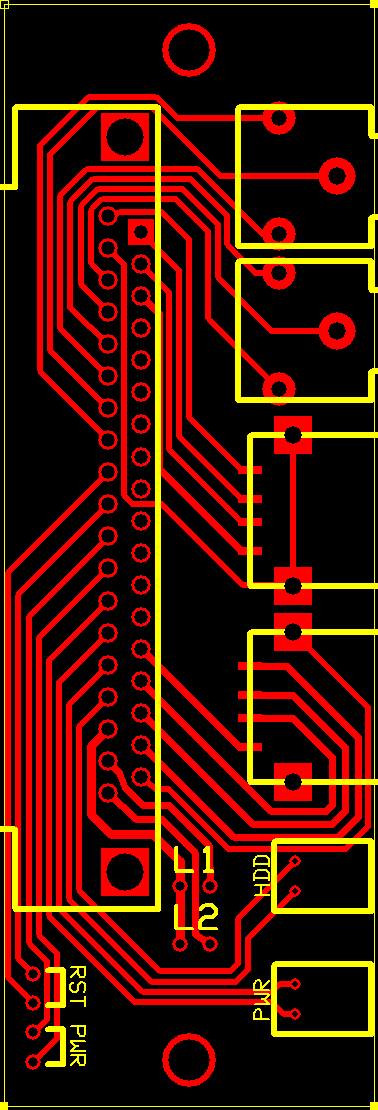

    The case-half of the PCB is designed.
    http://www.captainslug.com/modding/mk6_plug-bus_ch_pcb2.gif
    The case-half will be only female connectors while the tray half will be only male. This made the traces easier to do since Male and Female connectors have reverse pinouts allowing me to simply mirror most of the elements.
    The last part to design is the front panel interface PCB.

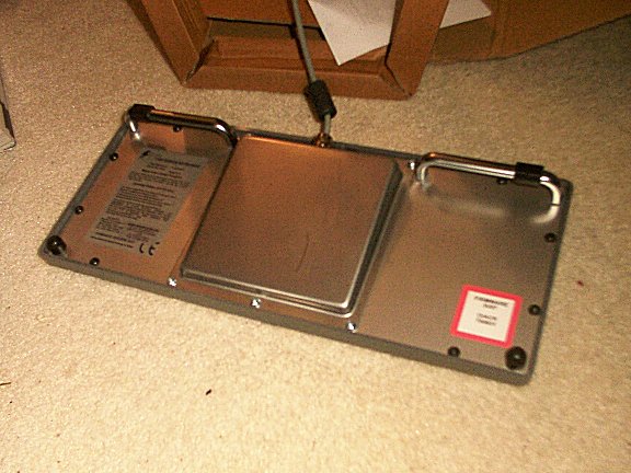

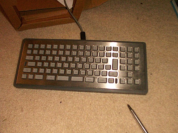

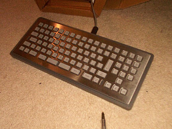

    My keyboard/deadly weapon arrived! I bought myself this for christmas this year after finding one on ebay.
    Storm 1100 series industrial keyboard made out of stainless steel and ABS with laser-engraved keys. It weighs atleast 10 pounds but it's not much larger than my portable USB keyboard.
    The underside is equally rigid. If I can get the keyboard apart I will be looking into using RIT dye to stain the outer shell black.
    Gleee! :D

    From looking at the pcb layouts, how are you going to connect the cables to each side?

    tyhat keyboard looks YUMMY!

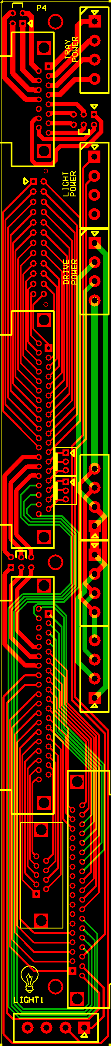

    The two PCB halves link together using 2 DB37 and one DB15 sub-D connectors.
    With that answered, here's the front-panel PCB.
    http://www.captainslug.com/modding/mk6_plug-bus_fp_pcb2.gif
    The Power, Reset, and Light Power toggle switches will connect to the PCB through headers. Mainly because the selection of PCB-mount switches was limited, but it will also afford the option of changing switches later if I want to.
    Similarly the Power and Reset LEDs will simply slide into horizontal-mount PCB sockets.

    Any idea as to a time frame for the PCBs?
    and on a side note, that has got to be the sexiest keyboard I've seen in a while. Does it use the old spring switches, or the crappy rubber ones that lack feedback?

    I'm still working on another case and I need some advice from the expert I'm in contact with before I get to work on the PCB.
    I'm fairly sure based on the feel of the keys that it's a membrane carbon-contact keyboard.

    Nice, too bad they're not backlit.
    Captain Slug: have you taken yours apart, can LEDs be installed inside to backlight the keys?

    No, the keys are opaque.

    Gotta love the keyboard, looks pretty sweet.

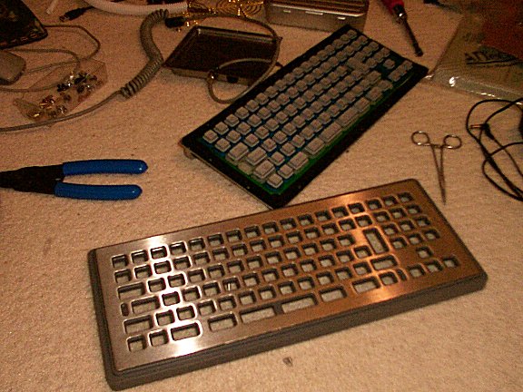

    The numlock and caplock SMT indicator LEDs are RED by default so I won't need to replace them! Yay!
    I took the kayboard apart, which was actually pretty easy minus the usage of some metric hex nuts that I don't have the right screwdriver bits for.
    I'll be dying the casing black as soon as I can go by some.
    The key-travel on this unit was a bit higher than I'm used to but I managed to fix that by removing the gasketing seal that fits inbetween the casing and the steel backing plate.
    All of the keys are independently supported by their own membrane so theoretically you could simply remove any of the keys that you don't want or find a way to make your own keys (they would still output the default character code though).

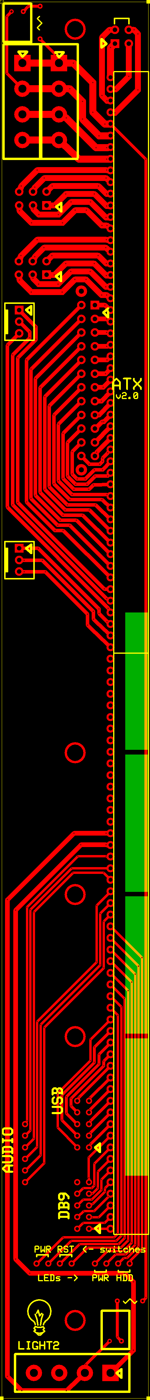

    After some concerns with using D-Sub connectors I broke down and decided the use high-amp (4.5AMP max!) capacity .030" diam. Mill-Max Pin Headers & Sockets, which look like this.
    One row of 100 pins on each PCB makes the traces much less complicated and allows me to use wider traces for almost everything. In other words EVERYTHING is connected with an overkill amount of trace so this should be a very durable device. These PIN headers also have a longer service life. I also added optional board underlighting LED sockets to opposing corners of all the boards for an aesthetic touch.
    All of this meant redoing all three boards, but in the end I'm much more satisfied with the results.
    This PCB will attach to the motherboard tray
    http://www.captainslug.com/modding/mk6_plug-bus_th_pcb3.gif
    And it will dock into this PCB which will be hard-mounted in the case
    http://www.captainslug.com/modding/mk6_plug-bus_ch_pcb3.gif
    And all of the front panel connections will be forwarded to this PCB
    http://www.captainslug.com/modding/mk6_plug-bus_fp_pcb3.gif
    The case-half and front-panel PCBs will interface with eachother through a rounded floppy cable instead of a D-Sub. This will not only reduce weight and improve cable management, but it will also make the end unit much cheaper. The revisions I made reduced the end-cost by atleast $20.
