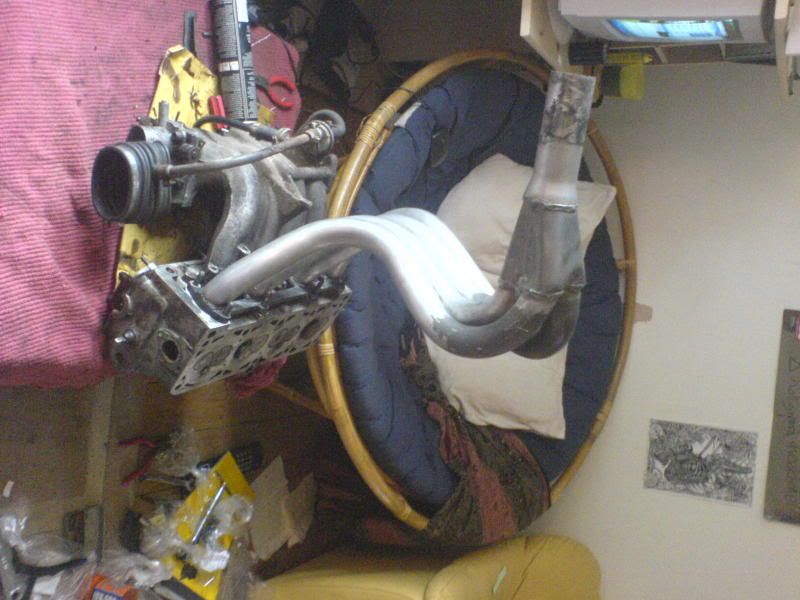

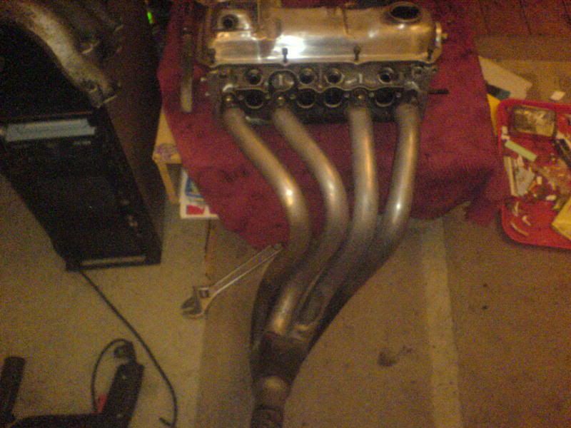

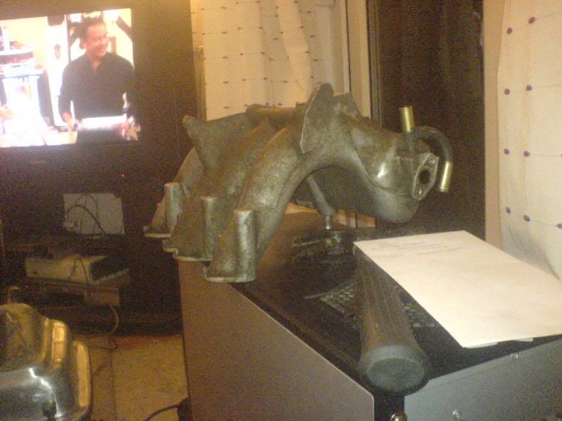

    4 Branch Manifold needs fitting - Will be polishing up over the next couple of weeks

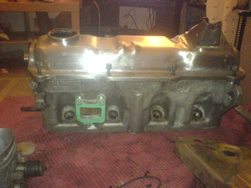

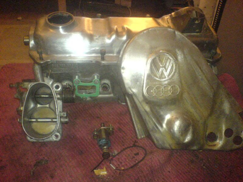

    polish rocker cover

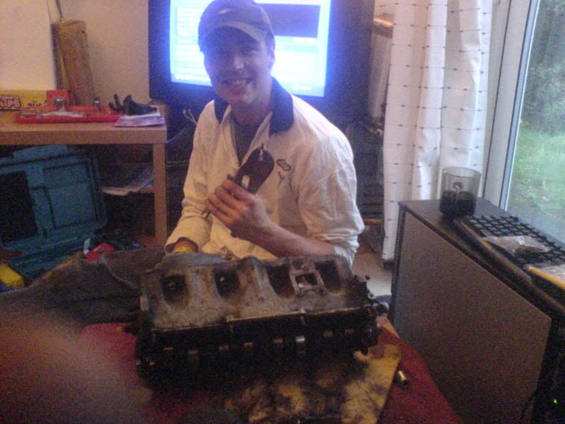

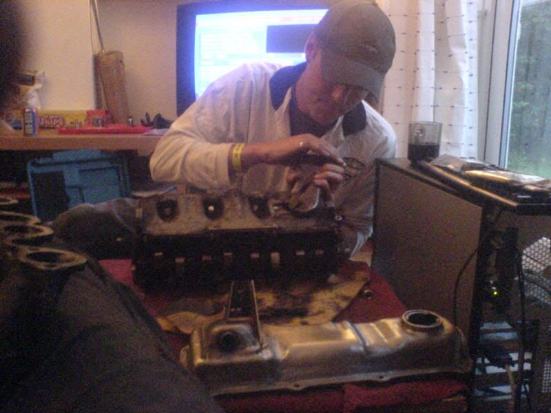

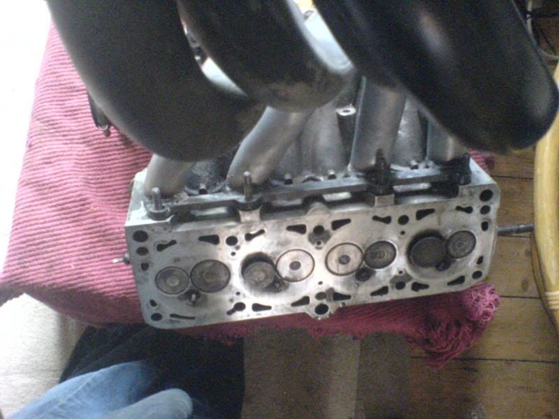

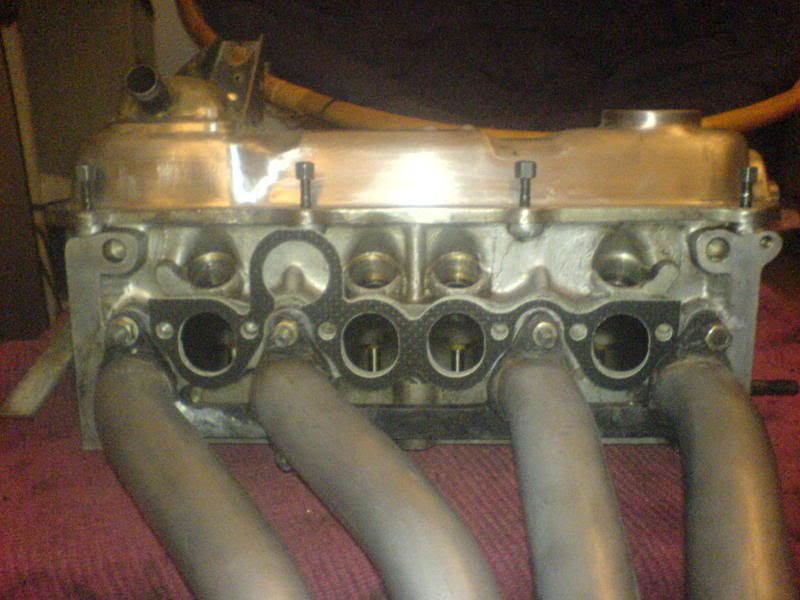

    The deal with the engine
    I haves me a 1800 GTI Engine i picked up, the following work has been done.
    Piper Cam
    Vernier Pulley
    Ported & Polished Head
    New Oil Pump
    New Distributer
    Bottom End Painted Black.
    I will be polishing up the throttle body, inlet manifold and rocker cover.
    Also got myself a full set of gaskets, o-rings, seals, bearing shells and loads of other ****ing bits i have no what they are, basically everything to fully rebuild a new motor :-D

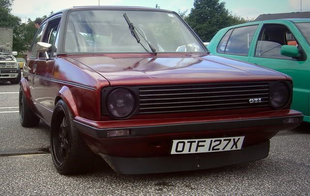

    Oh and the car at the moment -
    The arch damage has been repaired, and primered, still got to paint it back to the audi rot pearl
    pressed plates arent shown fitted
    also fitted a new gearknob, bucket seats, steering wheel, stereo, electric windows, replaced the air, oil, fuel filter, sparks, oil, coolant, leads, dizzy cap, rotor arm, adjusted trottle and clutch cables, new pedal rubbers, cleaned carpets, fixed loose bonnet catch, new driveshaft

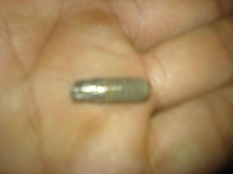

    Driving back from work today, just come off the motorway onto a dual carrigeway about 2 minutes from home when the sound of a bolt twatting some metal happens and an almighty knocking happens, so i pull over calmly into the bus stop without braking as i only doing about 20mph when this happened. Once i got into the bus stop the o/s wheel was seized up to **** and the car just stopped straight away
    jacked up the wheel to find to my dismay that one of the caliper extension bracket bolts had either come loose or sheered out of the mounting and my caliper was hanging by only one bolt.
    it had essentially cheesewedged itself against the brake disc and my alloy wheel :( busting the bleed nipple in the process and scratching up the nice new calipers.
    i tried to find the bolt in vain, but i managed to take some pictures, you can see the missing bolt, and the bolt thats holding the bracket to the caliper is also coming losoe.
    These bolts were torque wrenched tight when fitted to the car but needed no real tightening as they were proper tight out of the box.
    I either suspect that they were hi-tensile bolts used or they werent held in with loctite when originally fitted by the company who sold them to me, surely these bolts shouldn't come loose and disappear completely after only 40 miles of driving.
    I'm not impressed in the slightest and the fact that after only 40 miles this has happened, how the hell am i meant to put my faith in these brackets indefinatly, as i had planned on keeping these on the car for as long as she lived. I mean imagine if that had happened round a roundabout or when i was doing an emergency stop.
    anyone else had similar problems, or are you still running your 280mm brakes years on with no problems?
    I wonder how many people are going to whip their wheels off in the morning and check how tight the bolts are!

    my exhaust manifold is also seriously blowing so needs changing asap for that stainless beasty...

    right update of my work on the last few days

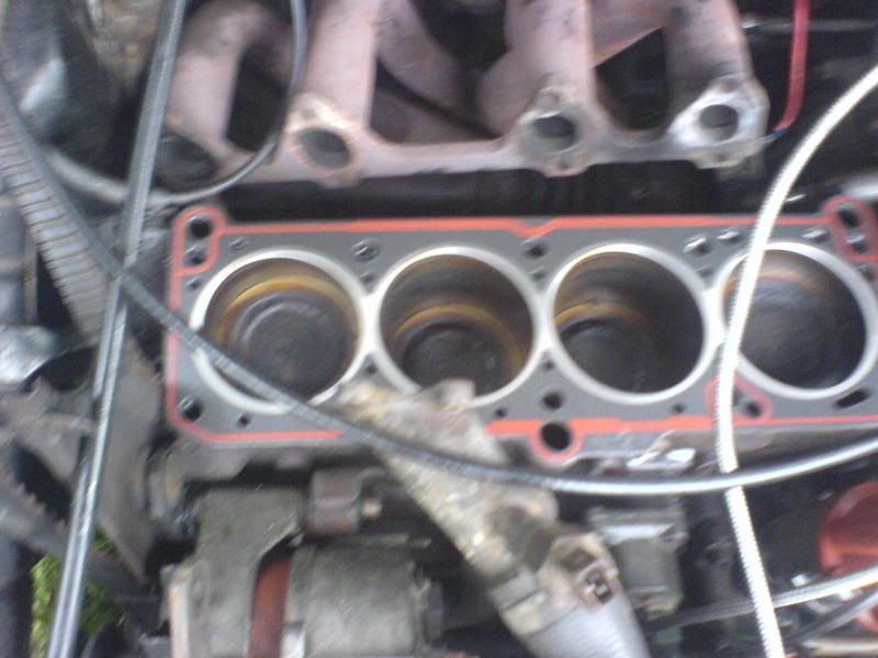

    whipped teh head off my golf, managed to snap three bolts from the water outlets and round off an inlet manifold bolt.
    replaced all new exhaust manifold studs, got new gaskets, cleaned up the face of the head and the head in general.
    also did a bit of polishing on the rocker and cam cover.
    the head with the new manifold attached just cos i wanted to look at it mwahahah
    after cleaning up the bottom of the head a bit, just a bit of carbon deposits well everywhere, must have been running lean for a long time!!!
    along came rick with some grizzly techniques
    and the bolt was free
    fiddle sticks yoooooo bolty
    inlet fannymold off, will be hammeriting it black before it goes back on
    injector seats - just a bit battered to say the least
    my progress of the polishing, not bothering with the throttle body, cleaning it up will probably paint black too
    some pics of the head cleaned up
    and a toureg i spotted in town sporting our plate. ****er (P1 KEY)
    also got walshies pooberg change, we scratched our head trying to idle once the new one was fitted but a *******o wire was at fault, all reet now. wooop
    cheers boyos

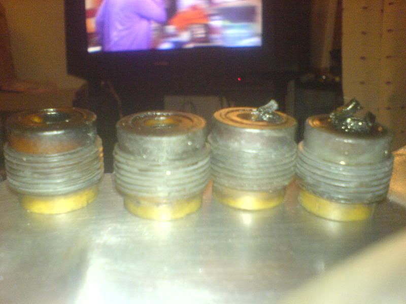

    ordering some 4 new injector seats tomorrow, making a pikey throttle body gasket out of a cereal box, picking up some hammerite spray. angle grinding the old manifold off from the centre pipe.
    not taking any pics of my samco coolant hoses but they are fitted now woot
