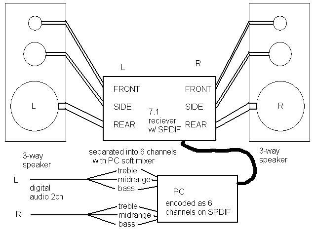

    Well, there I was, thinking. Scary things tend to result from this. Anyway, I made a diagram of my idea.
    This is just a rough idea, and you would have to worry about
    -Possible A>D conversion for the input
    -Quality of the amps on the reciever
    -Quality of the DAC on the reciever
    -Varying sensitivities on the drivers
    But, if you ,instead of using SPDIF, find a way to get the soundcard to output the separate channels, and have a quality multi-channel card, probably the Revo 7.1 or one of those M-audio Delta things with several channel I/O, then use six discrete amps or three stereo amps, and adjust them to balance out the spectrum, it might be a promising idea.

    Wait, so the goal is to upmix your 2ch source into that... looks like 6.1 setup?
    Hmm... looks a little too complicated. I like to just turn on ProLogicII :)

    what your doing is removing the cross over from the speakers.
    now couple of things here... dont do it this way.
    get an external crossover that you can either make yourself or adjust yourself because every speaker will have a different range as to where it splits the freq.
    you dont want to take an analogue source make it digital then back to analogue again
    and lastly using a 7.1 amp wouldn't be a good idea either.
    should really be - signal coming out of a preamp into an active crossover then into 3 pairs of stereo amps.
    its also not a new idea.
    naim, linn to mention just two have been doing it since the 80's im afraid.
    http://www.naim-audio.com/products/intro_crossover.html
    oh and if you want to push it to the next level think about using mono blocks. thats 6 amps for 2 speakers. no cross channel talk at all and all the benefits of active crossovers :D
