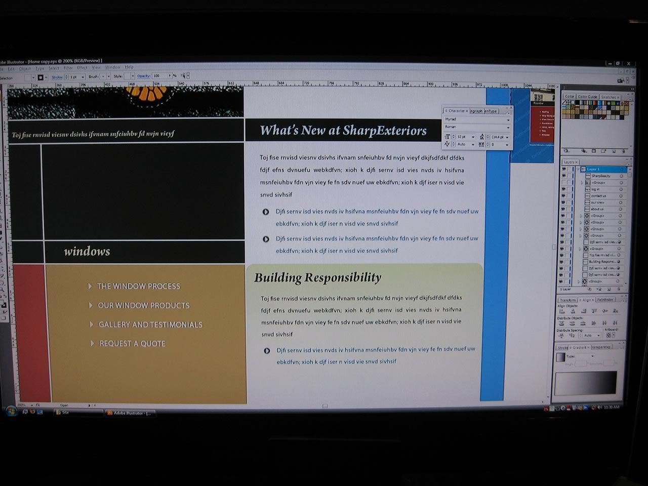

    At that distance the large pixels of the TV can't be very comfortable to look at. I know for a fact using my laptop on my DLP TV for watching movies, just sitting there on the ground setting up the external monitor kills my eyes and is impossible to read, and thats a DLP too. LCD and plasma TVs would be horrendous to look at I bet.

    @ozstrike - It's a 7" touch panel LCD that I have wired up to my Pico-ITX
    @mattthegamer463 - I expected the same thing, but to be honest it's not bad at all. here is a close up pic of image quality.
