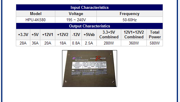

    This should give a bit more info on his Hiper PSU's spec:

    I think my early morning guess has just been proven! 20A and 18A rails, oh dear!

    nice research. 38 amps...lol just a couple off my guess.
