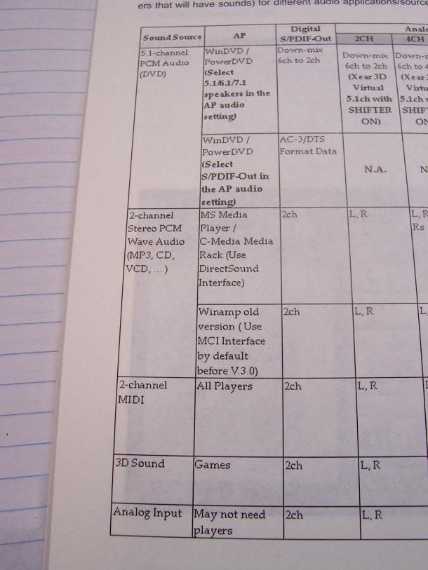

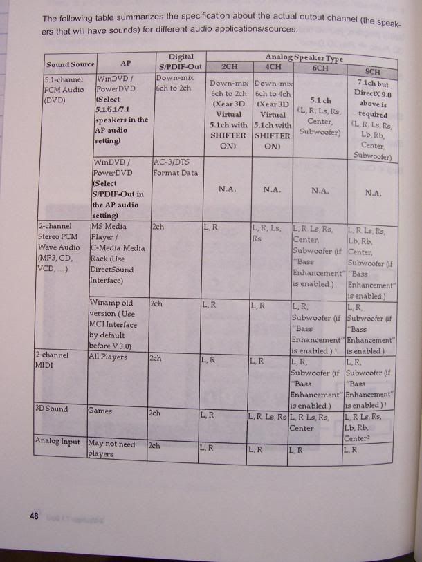

    I own this card, and unfortunately it will only encode into Dolby Digital Live! in games, to 2.1 audio. :( Even says so in the manual. But for movies, it will do 5.1 DDL encoding.

    The x-mystique gold will encode most games to true DD 5.1. If it is only coming out in 2.1 then you either have it setup incorrectly, or you are outputting through the analog jacks. The DDL will ONLY work through the digital output, although I am not sure if this will change with future drivers.
    There is a problem that the manufacture is working out with FAR CRY... The drivers will not allow it to work with DDL as of yet, sorry. Seems like you'll have to wait on that one.

    It's very easy to switch from DD optical to stereo analog. Open the control panel, change the setting from digital out to analog, and it automaticly chooses stereo output for you.
    Here are some photos from the manual itself showing that it will only do 2 channel audio using the digital output on the card, which is the only way to get DDL audio.
