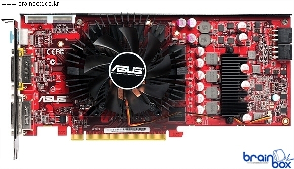

    i want to buy another cheap card to use in crossfire. this one seemed to fit the bill.
    can i combine my current card, an asus eah4870 1gb
    with this card:
    http://www.ebay.co.uk/itm/XFX-RADEO...TV_Cards_TW&hash=item4ab0146d5e#ht_500wt_1413
    i mean, they dont have to be the same brand do they? will they fit together?
    also, i only have two 6 pin power connectors for my card, but obviously i will need another 2 for this one. i hard someone say about molex to 6 pin? will these work just as well?
    like this:
    http://www.play.com/PC/PCs/4-/17470...tml?_$ja=tsid:11518|cat:17470187|prd:17470187

    Yes it should work perfectly fine. You can use two extra molex connectors for the 6 pins.

    The only thing to be careful with when using the molex/6 pin adapters is that the rail feeding it is strong enough.

    are the cards exactly the same apart from the diff coolers. i mean in terms of length and other dimensions and everything

    how can i tell? my psu is an antec earthwatts 650w. it was featured on bit tech some years ago apparently it was the best quality value psu

    That should have the guts to do it. The best way to check is is find out how much power the GPUs draw, then check the PSU manufactures site for how much power can be draw from each rail. What might be the best route is to put one dedicated 6 pin on each GPU and then use the adapters off the molex to the other 2 so it's spreads the load.
