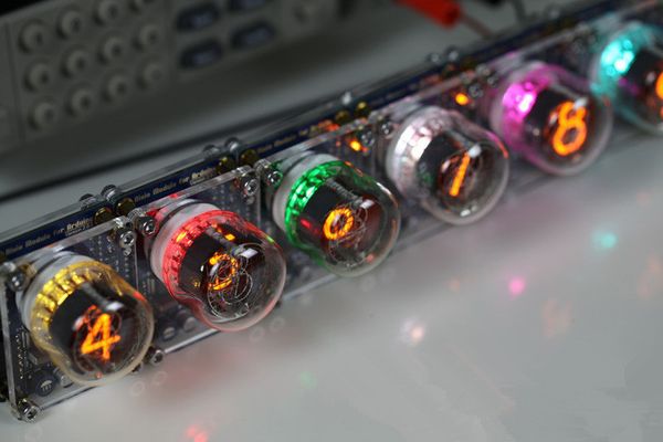

    Guys, I'm looking or nixie tube letters, like on the image below.
    Do you know where could I buy them?

    Yes indeedy! Basically you have two types of nixie tubes: those with numbers, and those with symbols (often paired with number nixies to indicate what units of measurement those numbers refer to). These symbols can be letters such as A (amps), V (volts), F (Fahrenheit), W (Watts), H, S, T, h, P, m or other obscure units, but also the degree C symbol, Hz (Hertz), +,-, a sinus wave, the mu (micro) symbol, the Ohm symbol, % or some other such thing. Of course a symbol nixie will only carry a particular selection or combination of these, and you certainly won't find all the letters of the alphabet represented.
    Because symbol nixies are meant to be uses in combination with number nixies, you'll find that some number nixies come with a matching symbol counterpart. IN-14 number nixies have IN-19a, IN-19b and IN-19c symbol counterparts (each carrying a different set of symbols), and IN-12 nixies have IN-15a and IN-15b counterparts.
    The top picture in the OP seems to show alphanumeric nixies. This later (and fairly rare) addition was a nixie tube that carried a 16-segment filament display that allowed making up numbers or letters.
    Nixie tubes are sold on eBay, usually as surplus stock, by Eastern European sellers (who are legit, don't worry). You can also Google for nixie tube web stores, usually American, which offer a good range but are also more expensive.

    Does it mean that first photo might be 3D rendered, cause like you said I won't get all letters?
    What I want to achieve is a word CHIMERA made of those tubes.
    I noticed there are those vertical ones were they are soldered at the bottom, but also I saw some more round or those rectangle ones like on top photo that are mounted/soldered in the back.
    Is that correct?
    I'm after medium sized, like 3-4cm tall ones.

    Depends. They could be Burroughs B5971 tubes. They are soldered at the back, as it were, and 26mm high.
    The ones that are soldered at the bottom are fore instance Burroughs B7971 tubes. They are bigger: 127mm high, and much more costly.
    You can of course use conventional nixies, but only if they conveniently happen to cover the letters you need. :p
