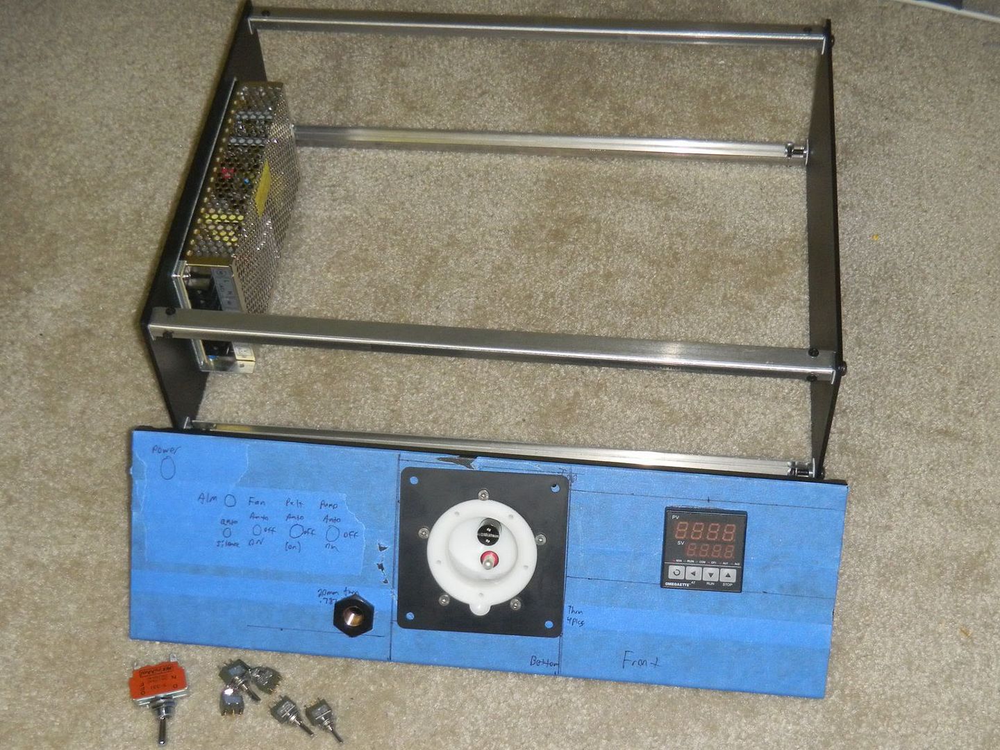

    Small update, been wrapped up with other stuff, but I got the power supply mounted, and PID thermostat cutout made (and temporarily installed).
    (now with bigger thumbnails)
    Aquabay and thermostat are both just sitting in there, pay no mind to if they arent straight
    Closeup of the switches due to be installed soon. However, I forgot to get the pretty trim piece nuts for them so I may actually be holding off on final installation.
    Said pretty trim piece nuts installed on another previous project of mine. Along with some Apem LED indicators.
    Teaser image, no further explanation for now ;)

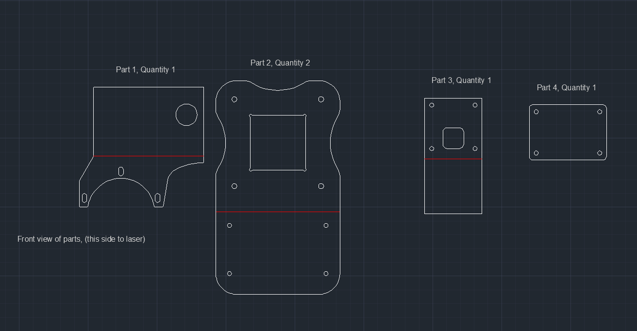

    More crap in the mail today! Got some lasercutting done by Pololu on some 1/8" smoke plexiglass. Left the paper on for most the shots, and quite a few of the parts will need to be bent still. That will be done this weekend.
    Aquabay rear mount fill port bracket
    Mounts up like so.
    Pump vibration isolation mount.
    Mounted up
    Back side to show hole for inlet. Yes, the tubing will have to be done up before the bracket is mounted.
    There will be a base piece, pictured here, that will have either 1/4" or 1/2" of soft neoprene foam that provides better vibration isolation then the stiff rubber mounts.
    Water block mount, 2 will be used, one front, one back, to get rid of any flexing.
    Nevermind the glare, just showing the nice alignment
    The copper base fits nicely too, protrudes enough to prevent any problems.
    LCD smoke tint window, and LCD template to make it extra easy to lay out.
    Template pictured over top of the LCD. The hole alignment is off, but not as bad as it looks in the picture due to perspective. Guess the datasheet on adafruit was off a touch. If only I knew where my dial calipers went off to.
    Thats it for now, more jigsawing, heating, bending and fitting up this weekend.
