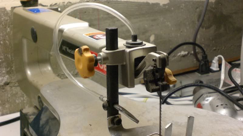

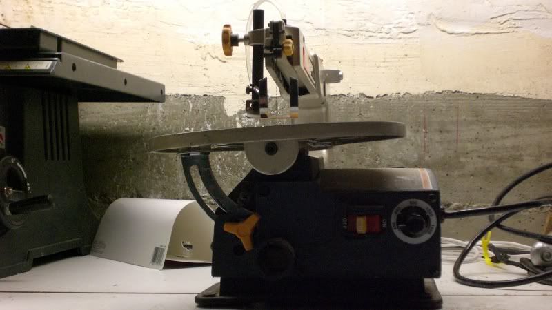

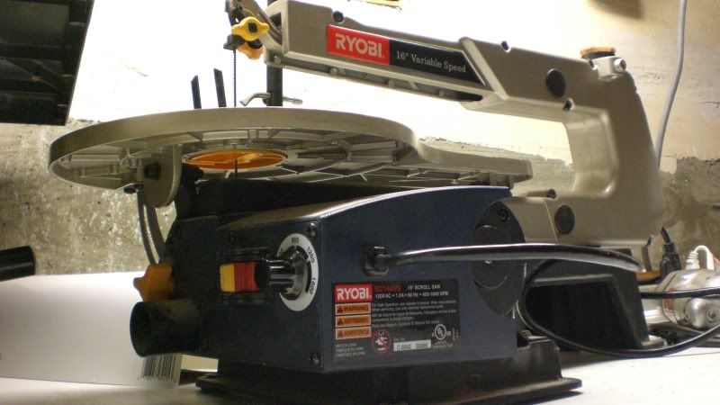

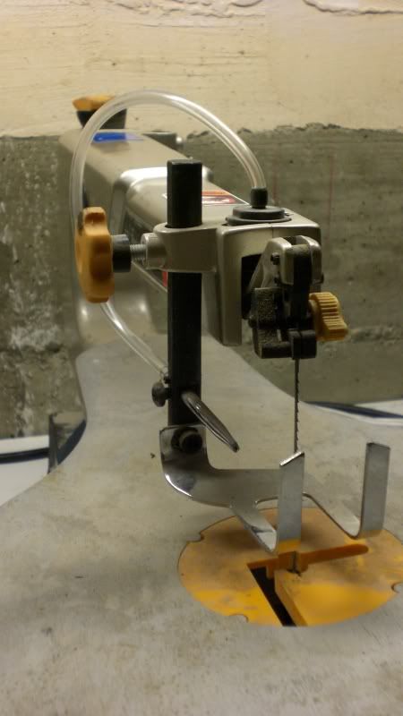

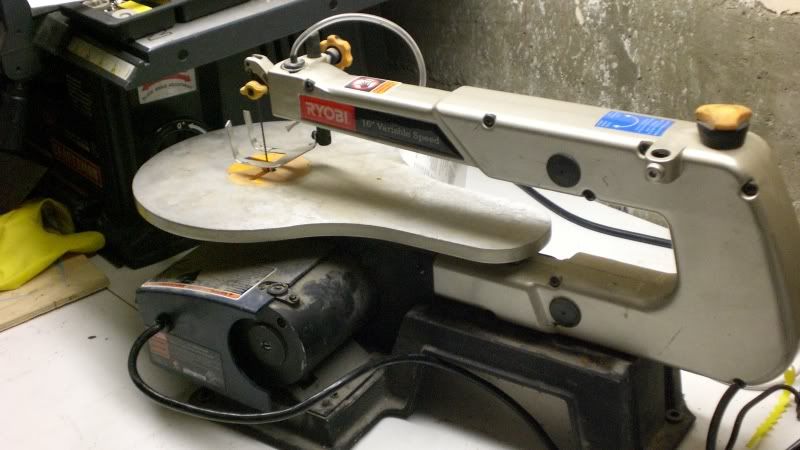

    New toy!
    aka Tool!
    aka the Ryobi 16" adjustable speed scrollsaw:
    Ta... Da...
    (ah... wish I noticed this before my first cuts... not set level! I was all over the place trying to cut a straight line!)
    Didn't get much in the way of actual modding done today, but I did drive over 30 miles on the wet highways in rush hour traffic to pick up this deal I found on craigslist. Slightly used, but everything works well, at least to my inexperienced eye. I had some real problems with cutting a couple straight lines earlier, but that is probably due to the table being off level by almost 10 degrees! (found that out while I was cleaning it up.) Haven't tried any more cuts since then, but hope to be able to stay on the line (or at least on a consistent margin from the line) in the next cuts.

    Nice scroll saw, that's a tool very high on my list to purchase.

    Thanks. I'm pretty happy with it. Next on the list is a bench top drill press, then I have to make a nice(solid) stand for it the drill press and the scroll saw (it really vibrates the table.) A friend at work has an old drill press (with speed adjustment by manual manipulation of the drive belt and spindles. I think it's a 5 speed.) He's offering a good deal, and may throw in some bits too.

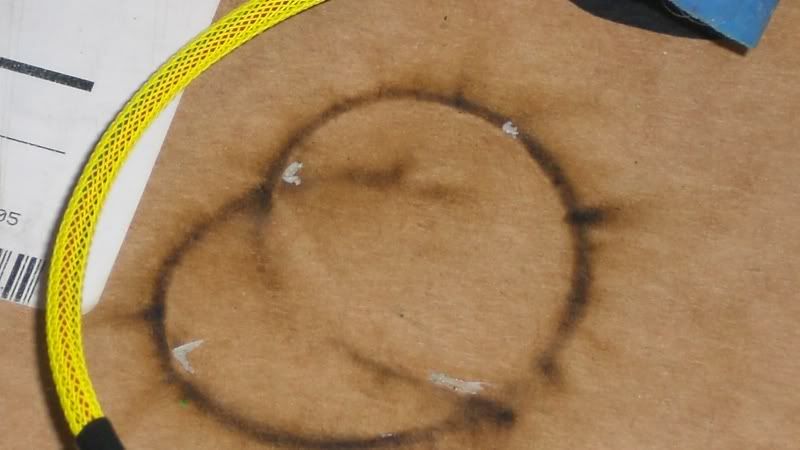

    And now, for the pics.
    Even though the previous mystery pics were not a big crowd participation cue, I'll bet you know what these pics said to me...
    It all starts and ends with this:
    What is it?
    hmm
    :worried:
    Who can tell from these shots what happened? I'll give you my guesses later.

    That's a burn mark from cable shorting out my friend lol. I did that recently while testing my 3.5mm fan connectors.

    Fire! Fire!
    Damn, you're good! Yep that's correct. (I might have given it away with the other pics, but felt the whole story needed to be told.) Care to try the previous mystery pic? ;)

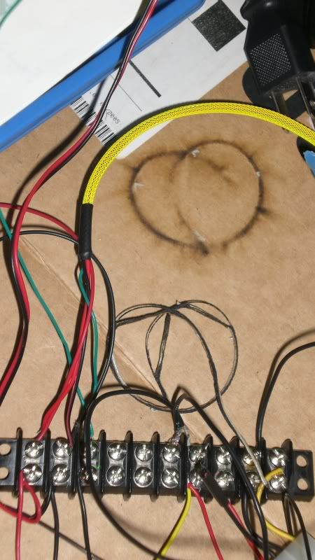

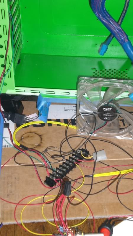

    Yeah this was the first time I actually put wires on fire! (I did put a hairpin into a wall socket when I was a little kid that sent sparks flying everywhere, but that was way back when.)
    The wire that melted/caught on fire was a single cable from an IDE ribbon cable that I was using to bridge the 12v terminals. I'd originally hooked everything up to my weak bench PSU, and nothing happened. When I disconnected it, the PSU did start up, so I figured I was drawing too much current for the psu to handle, and then hooked it up to the newer 350watt antec. As soon as I flipped the switch there was a big poof of smoke, and flames from the melting wire which scorched the cardboard below.
    I'm not sure if it's (A)just that the wire was too little and the circuit is fine (ie, I can put a thicker gauge wire and not worry) or if (B) I have too much current being pulled for safety, or (C) if I've cross wired some things which is causing a fault. I haven't had the time to test anything to make sure I didn't blow them up, but I figure the shorted wire will have saved anything from burning out (like a fuse!)
    i've got 3 fans hooked up, with a switch for 2 of the fans LEDs (as detailed previously, switching the ground), and the potentiometer to control the voltage going to the 3 fans. The leads for the LED indicators are connected straight to ground.
    I guess I should be smart and actually count out what the draw on this circuit is to be sure... especially since I still want to have another 2 fans and the potentiometer and leds (6) added to the circuit.
    Also on a related note, is it important to have both the ground cables from the molex connected, or is it just ok to have one, along with the red and yellow to feed the terminal strip.

    Any tips/thoughts on figuring out the wiring? Does it seem like it's just too weak of a wire, and thicker wire would work fine for it? Or is this evidence of a short? I'll post up a pic of the current scheme later tonight, once I draw it out. :D

    one quick point - don't coil up any wires - stretch them out until you're ready to finalize the length. Coils will make any current and/or heat greater. Coils wills build upon them selves and get hot.

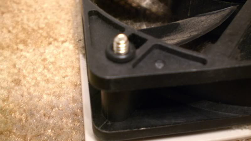

    Ah I see, I did miss a mystery pic. The background is black and looks like plastic. The only part of the case that are plastic are the front, the feet, the rear cover and the pieces on the top of the case. The plastic surrounding the white piece in the picture has prongs so it looks like the power or reset switch housing.

    You're partly right... ;) but you're wrong...:D and there shouldn't be any white. I like the reasoning though. You missed a plastic part, common to almost all cases.

    Common to all cases ey? That leads me to think it is the drive rails even though it doesn't look like it. Or perhaps the plastic bay covers or the Power or HDD LED, if not I am stumped lol.

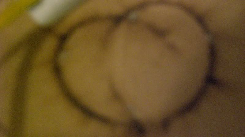

    It's a hard one... real blurry. I still can't get reliable macro shots.
    Here's one in focus. :hehe:
