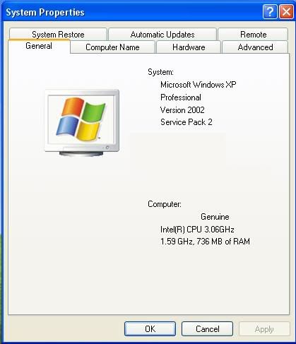

    so i have a spare p4 system i have loaned to my girlfriend, done a little light modding to it but my problem is that the 3.06 p4 runs at 1.56, I've tried a lot of things in bios nothing seems to change it. The motherboard is dated, its a syntax S651M, any help would be appreciated, tho this isn't a crucial problem the computer dose work fine for her im just aggravated it's missing 2/3s of the cpu. heat doesn't seem to be the problem, with the cpu in the low 40c~

    Well there isn't speedstep, in the bios. but here is a screen shot from cpuz

    Seems like the multiplier is set wrong. Do you have any options in BIOS to change that?

    yep multiplier should be 23. Does it change under load (just to make absolutely sure it's not some kind of speedstep style thing) leave cpuz open and run superpi or prime95 or something to load the cpu.
    if you can set the multiplier in the BIOS then do so but I suspect that it won't let you. All this looks like your CPU is not supported by the BIOS revision so it's reading the required multiplier wrongly. Maybe you'll be able to get hold of a newer BIOS and flash it otherwise you may have to settle for low speed.
