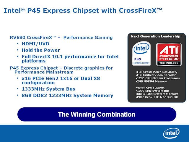

  11. Guest-23315
    Guest-23315 Guest
  12. wyx087
    wyx087 Homeworld 3 is happening!!
    15 Aug 2007
    11,434
    471
    only 1333Mhz system bus? i thought all 4 series chipset will support 1600FSB.......
  13. Guest-16
    Guest-16 Guest
    Uhhhh.. OK.
    1280 Stream processors - 4x that of the HD3870?
    I find it hard to believe that Intel will be advertising such a thing on official documents, unless it feels super-threatened by Nvidia.
    Most of the CPUs will be 1333 and P45 will be mainstream so if you want 1600 I'd hazard a guess you'll have to buy a better chipset - X48s replacement. But then you think - why do I want to buy P45 then??
  14. wyx087
    15 Aug 2007
    11,434
    471
    PCIe 2.0 native support (been reading the PCIe 2.0 thread over on abit offical forums, seems some people have compatibility problem with the x16 slot, but x4 slot worked fine, strangely enough)
    and 1600FSB support, if most processors are 1333FSB, there's no point going from P35 then :wallbash:
