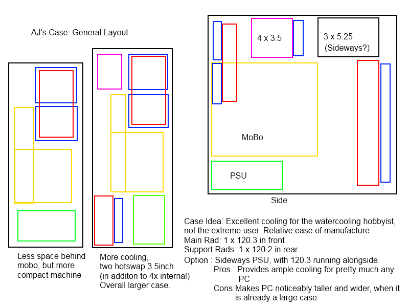

  11. Ajhayter
    Ajhayter What's a Dremel?
    10 May 2010
    17
    Right, here is my initial design.
    Exterior of the case is going to be largely minimalistic.
    3 5.25 inch bays allows for 2xDVD drive and a fan controller, or a mix to allow drive bay res.
    Moving HDD's to top allows more space at the bottom for pump/res configuration.
    While a comparatively low HDD count compared to a lot of cases, my goal was to look at the water cooling hobbyist with a light interest in it. I don't think the majority of users would need more drives than that.
    Before I go getting concrete on design of the exterior, can you see any issues with interior layout? Personally I prefer the layout with only the front/rear rad, with no side rad at the bottom, as this allows for a more compact machine, both height and width, but do you think the extra cooling is really required? Let's face it, most people are not running tri-sli.

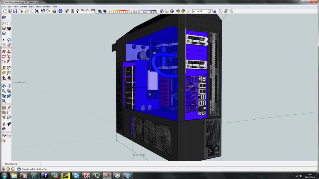

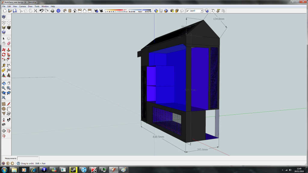

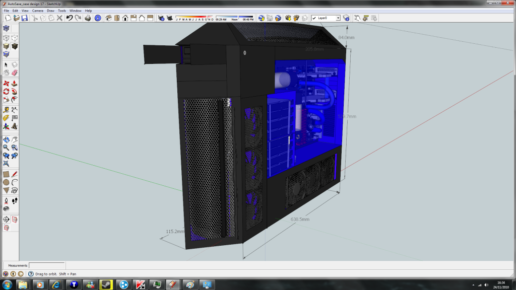

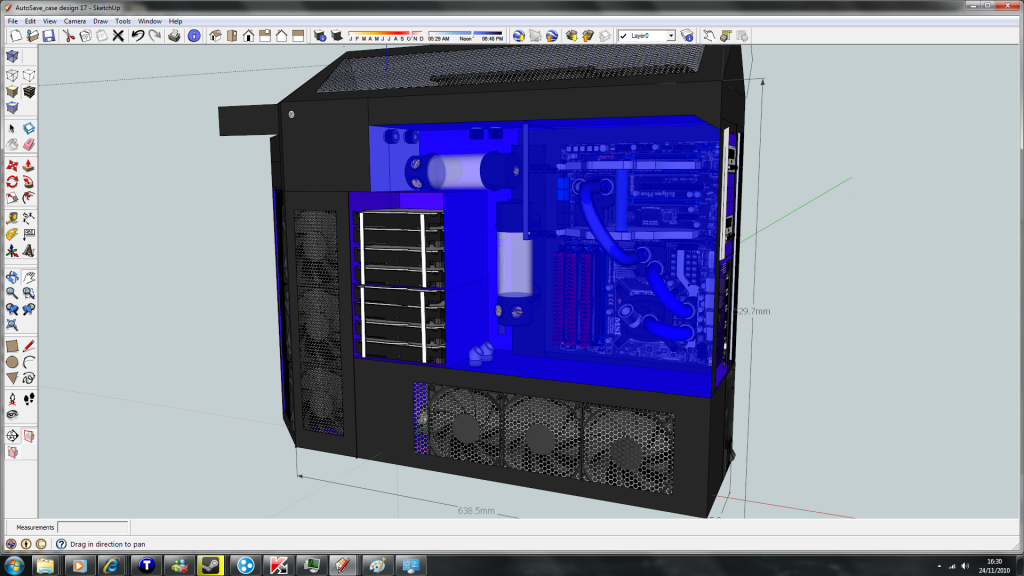

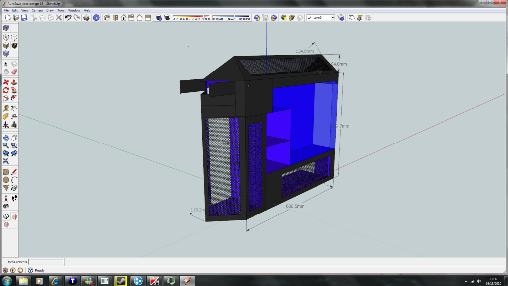

  18. MrMads
    MrMads What's a Dremel?
    24 Nov 2010
    Case Design by Madboy
    Hi guys I am new here to Bit-tech forum, but have been a long time veiwer of the website. I have built and designed many PCs in the past (never a case though lol). So here is my current design
    I call it the Rapture
    here are some of the features the case incorporates
    - 3 isolated cooling zones
    - spaces for 1 triple rad in the bottom compartment
    - space for 1 triple rad in the front (with 6 fans) or 2 triple rads (with only 3 fans)
    - space for quad rad in the top (including the monsta quad rad)
    - space for a inovatek passive radiatior (with indepent cooling zone)
    - capacity for 3*5.25 inch drives
    - 8*3.25 inch hard drives
    - mounts and spaces for 3 pumps (lianing DC12)
    - mounts for 2 reserviors)
    - removal motherboard tray
    - sloped front and top for innovative looks and syle.
    - if the bottom rad is swapped for double rad, then space for dual PSU
    - mounting points for mcubed Tbalancer
    - custom designed cable cover for the motherboard
    I will add the pictures of the case with components added in to show how the design can be adapted to include all the above
    The dimensions are similar to a Silverstone TJ07 case (without the sloped top and front)
    Edit-
    I have been working on the pictures of the internals with the different components (still needs some more work with extra mesh and vents to be added)
    So here are a few teaser shots of what i have done so far
  19. Combatus
    Combatus Bit-tech Modding + hardware reviews Lover of bit-tech Super Moderator
    16 Feb 2009
    2,756
    69
    Welcome to the forums!
    That's a very interesting design - don't think we have many like it yet. So the drives are mounted in the side? Looking forward to seeing some components in there!:D
