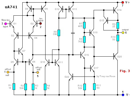

    Are you using a photodiode or a phototransistor? They are 2 different things, a phototransistor has a high gain, but you need to supply power to it, a photodiode is actually a current source when light strikes it.
    If you are indeed using a photodiode, the kind of circuit that is commonly used is called a 'photodiode transimpedance amplifier' The schematic you posted looks more like something that would be used for a phototransistor. Though I would think you would need some sort of bias/pulldown resistor on the non-inverting input to keep leakage current from keeping it all the time.
    Oh, and if you wanna use transistors...
    schematic for a 741 opamp... :lol:
    If you are using a phototransistor or a LDR you could make it part of a voltage divider, and either hook it to a comparator, or you could use a zener diode of whatever voltage you deem appropriate and a darlington transistor together as a switch.
