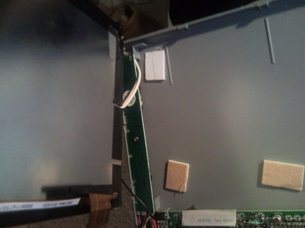

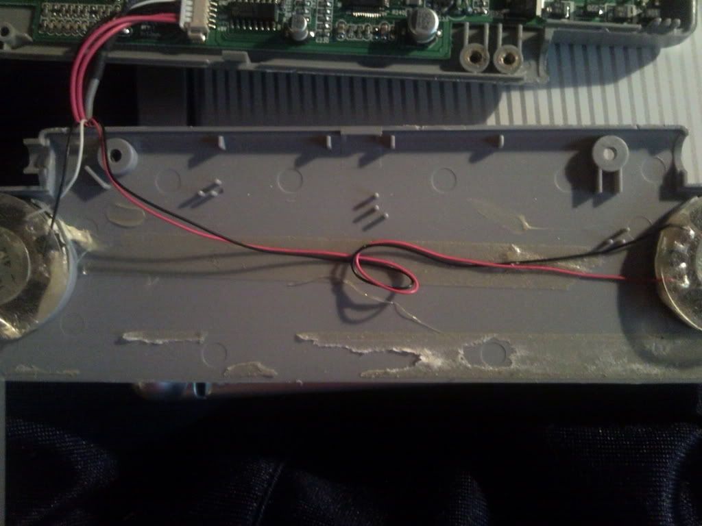

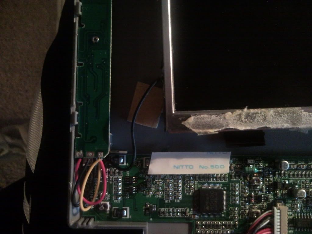

    i have noticed that on the base of the unit, there is a switch which allows you to use the aux as input or output... this may complicate things.... i also have uploaded some pictures sorry for the massive size but it helps with detail i guess! (a little large b/c they were taken w/ a 5 mpxl cell phone) i have just taken of the wiring... maybe someone can help me figure this stuff out!
    here i have taken a somewhat blurry zoomed out picture of the overall project:
    this is obviously the wires to the speakers. these branch off of the main bundle of wiring from the base of the dvd player to the lcd:
    here going off to the bottom left is the main bundle of wiring from the base. these connect to what must be the controller and if i can figure what wire is for the a/v input i should be able to tap into it. (correct me if im wrong please):
    now begins where i am confused... first of all this is to the left of the above image (you can see the clip so you can tell this by yourself :idea: i believe that thgis is the electrical wiring for the lcd. which would make the black ground, and the yellow/red pos/ neg?
    and last but not least the picture of where the two wires from the "electrical wiring board" (made up term) connect to the lcd.
    so please dont bite my head off cause i think this is a stretch, but if i were to leave all this intact and just tap into my aux input wire, i could use the method used by ben heck to power my lcd.......
    i need suggestions plz!!! and if anyone notices that i guessed something wrong, please correct me...

    Unless I'm mistaken, the red is 5v pos, yellow is 12v pos, and black is negative. as for the white wire I have no idea what that could be
    and uploading to photobucket and using the auto resize tool will help the sizing issue (640x480 is the usual size)
