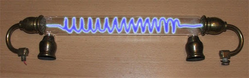

    Now I have a question for wiser than myself. I hope the guys from LC could help me:)
    Do you remember my distiller?
    I've cut off the glass stubs extending on the sides. Otherwise it wouldn't come into the pipe.
    And now what I want to achieve.
    Glue in this place some stubs to LC. Except that I do not know what kind of glue to use to stick it to the glass. The second problem is that I will set the tube in to the pipe. I can not glue the stubs, and then make it through the brass. I want to drill a hole in the brass - may be greater, and only through this hole fix them in distiller . Maybe silicone used for aquariums would be good enough? Or maybe one of you has a different idea how to solve this?
  9. kelmannen
    kelmannen What's a Dremel?
    5 Feb 2011
    377
    6
    Well... You COULD try with glass glue :)

    Are you still going to run a liquid through it? I'm not sure what you'll be able to use and keep it leak free. The glass and brass will change shape with temp changes. You might be able to get away with a crap ton of silicone, but I'd keep an eye on it.

    I'm sure that in a right circumstances and with right equipment I could bend it. But I don't have them in my workshop. I've tried boiling with no luck. I've needed at least press and form.
    Yes. I want to use it as a reservoir. And that's why I'm asking for yours advice. My last LC mod is 10 years old.

  19. barry99705
    barry99705 sudo rm -Rf /
    20 Apr 2008
    815
    15
    I really like the second one. What would be really cool, would be to pull some el wire through the curly part and just use the chiller as the res. Crap ton of silicone "should" keep it from leaking. Hard part is going to be filling it.
