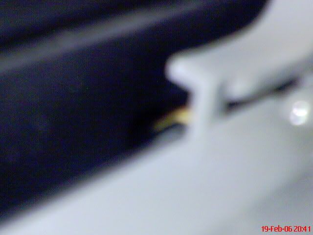

    there is no eject button on the cd rom drive, that is why i cant open it, there is just a hole where the button wud be....
    thats is where the eject button shud be.... but of course cos its a mac, they have gotten rid of it.
    sorry for unclear pics, phone camera.

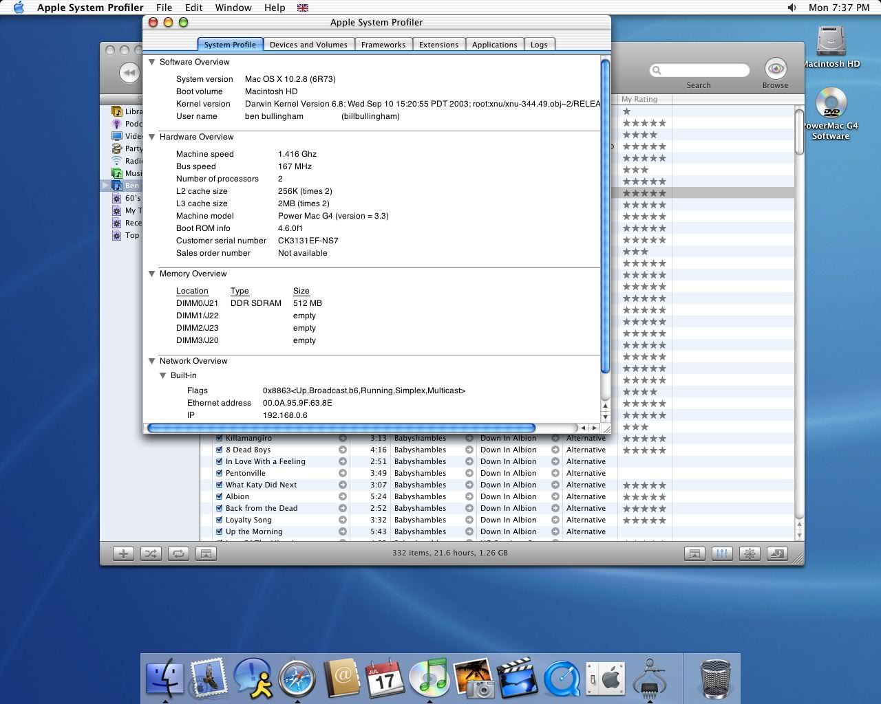

    Sam0r: the specs are: [​IMG]
