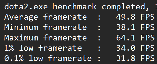

    By default it seems to max out around 225ish with the 240 cap which for whatever reason it does not hit, so I set max_fps to 1000 for more, so perhaps the 3080 is hitting the cap too.
    My frames were a simple play of course, using this replay below, my numbers are more modest, 300
    Benchmarking Dota 2. Benchmarking a game usually means… | by JJ “PimpmuckL” Liebig | layerth | Medium
    Numbers running that taxing replay
    Ryzen AI 9 HX 370 with 890M APU @ 2560x1600 on battery, not bad at all.
    Ryzen 9950 x3d with 5080 @ 3840x2160
    Tried it at 2560x1600 and barely any change, CPU limited, GPU running at about 50% at this res as CPU can't feed it, more power needed :D
    And for the LOLs I disabled 75% of my CPU because old games don't really like all the cores and SMT etc. making my 16/32 chip an 8/8 chip.
    2.5K
    4K
    Razgrad likes this.
